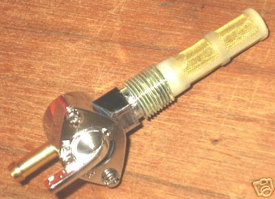

Since I want to do more riding and less tank fiddling, I decided to make my own replacement. I'm just using a standard brass 1/8" NPT valve for now. I'm also going to use viton washers and a quad shaped o-ring. If it seals good, I'm going to re-tap and replace the valve with a 3/8" petcock that's made for old harley tanks. It's chrome with a screen and a reserved switch.

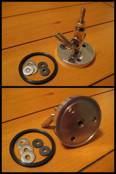

I made the base out of alum. It's the same diameter as the stock petcock and the seal fits the groove. I made it pretty thick so it would stay nice and flat when tightened down, and also so I could use the original jis screws. I left the tank full all weekend and had no leaks. It used to leak bad if I put any more than a gallon in the tank. Even worse if I tried to fill it up.

So did you custom tool the base or is this a part I could find and modify from a hardware store/motorcycle supply place? This looks like a great replacement solution which I need badly. Any help on how I may achieve the same results would be appreciated.
