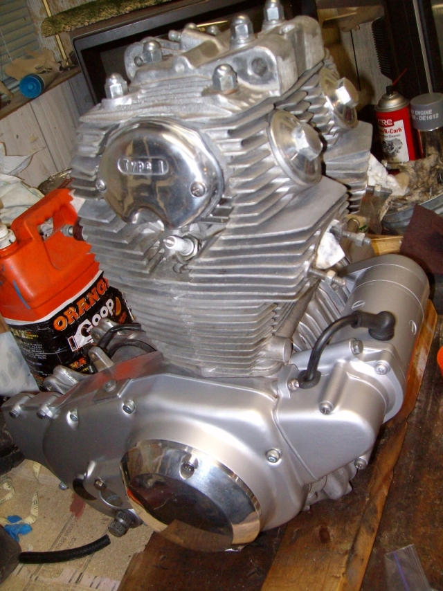

Latest progress. We took the rear wheel and swing arm off and started cleaning the frame and wheels. I'm running low on shelf space so I put the side covers and starter on the cleaned up motor (Picture attached).
