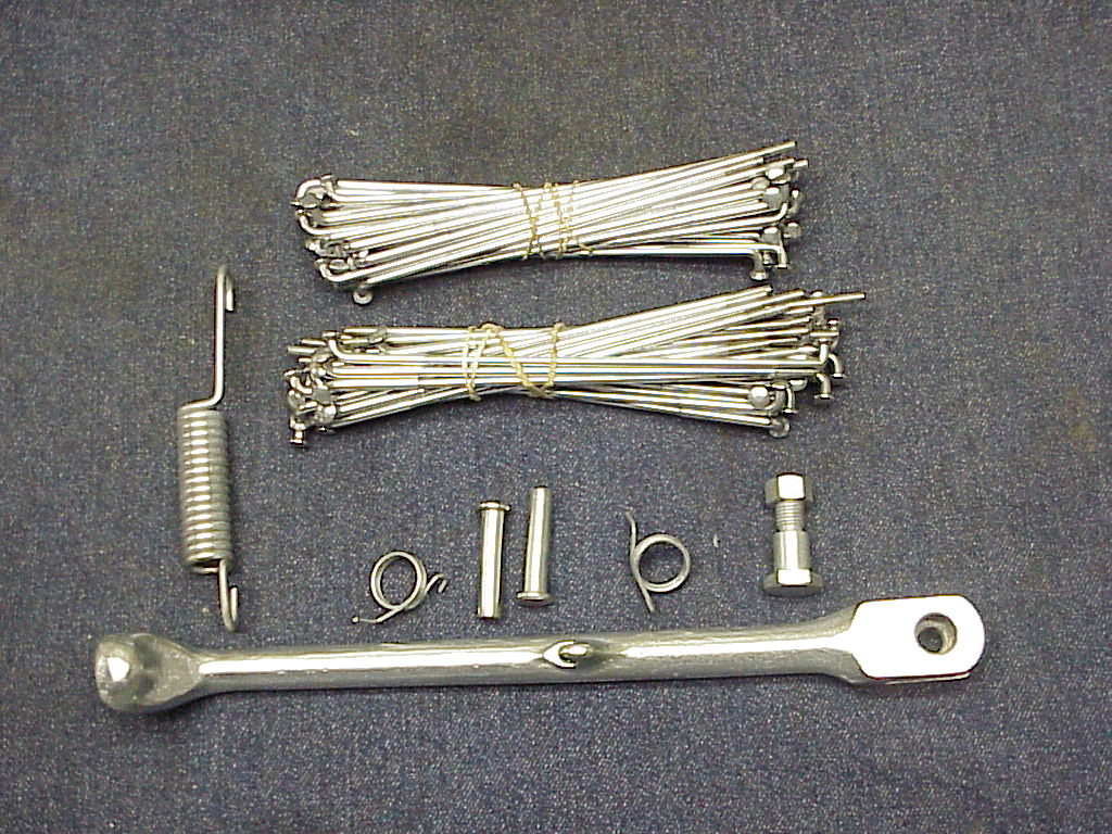

Here's some pics of the latest parts. I'm not acid cleaning any of the high stress or strength parts like springs, pins, etc. Instead I'm either bead blasting or wire brushing and thoroughly degreasing. Everything I've read says that the H2 embrittlement risk is thought to be more related to the acid prep process, rather than the actual plating process. But just to be safe, I still bake all the high strength steel parts after plating.
I did find that deep rust pits don't like to plate. So for those areas, I heavily bead blast until the pits are more like shallow bowls. Can't screw up the surface anymore than the rust did so no harm done. And the plating has no problem throwing into those bowl areas.
The spokes, as you can see in the attached came out great. If I saw them at a swap meet, I would think they were NOS. Lots of time put into them, since they were all cleaned individually by hand with a steel wire brush. But the effort was worth it. You cannot get new spokes for certain model bikes, not even from Buchanans, so having this process available is a great added tool to any resto job.
