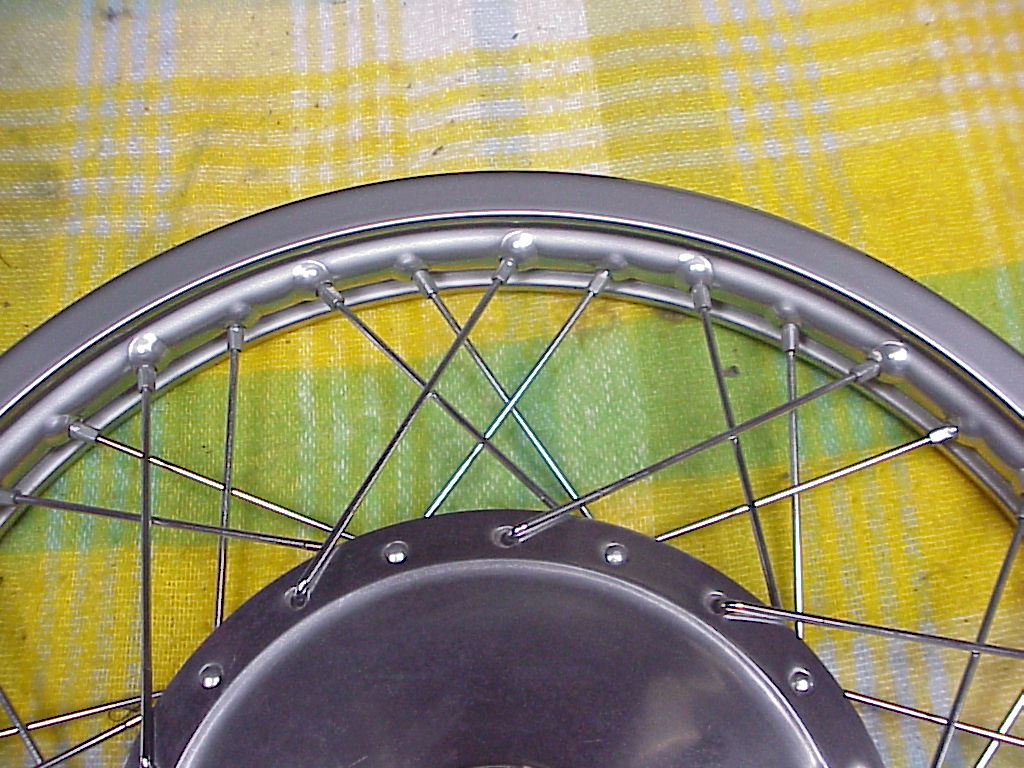

I ended up having my somewhat ugly OEM CL77 rims powdercoated over the holidays and picked them up on Monday. It cost me $60 each to have them done in what is called "chrome". It is definitely not chrome, but I knew that going in. The guys at Powertech are stand up guys and have samples of all the colors and finishes they do. The chrome is pretty shiny and my goal was to get close to what aluminum rims look like. They came out a little greyer than aluminum, but they look a heluva lot better than before and won't rust. There was another color that was more of a true silver and probably might have been a better choice to emulate aluminum rims. Maybe next time.
I did not do a lot of prep work and had I known they would have looked this good, I probably would have had them sand blast them and then give them back to me so I could fill in the areas that were pitted or marred in some way prior to powdercoating. But I didn't and you can see the pitted areas in the valleys on each side of the spokes. But the goal was not to make them perfect, just make them decent and prevent future rust.
So attached are two pics of the front wheel. The spokes and nipples are the ones I replated and posted pics of here previously. I'm very happy with how the wheels look. I think that with tires mounted and the wheels on the bike, somebody will have to look twice before they realize that the rims are powdercoated. I've got $120 into the two wheels versus about $600 for new stainless spokes, nipples and Excel shouldered aluminum rims.
