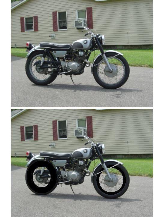

I wrestled with having them done in black. So, I modified a picture of my bike by blacking out the rims and it just did not look right. So I went with what they call "chrome", which is really a very high luster silver. It need to be clear coated because the silver is not very durable. My hope is they end up looking like shouldered aluminum rims.

Attached is my a pic of my bike with the rims chrome and then blacked out. I think the black rims make the bike looks like somebody put it on steroids.
