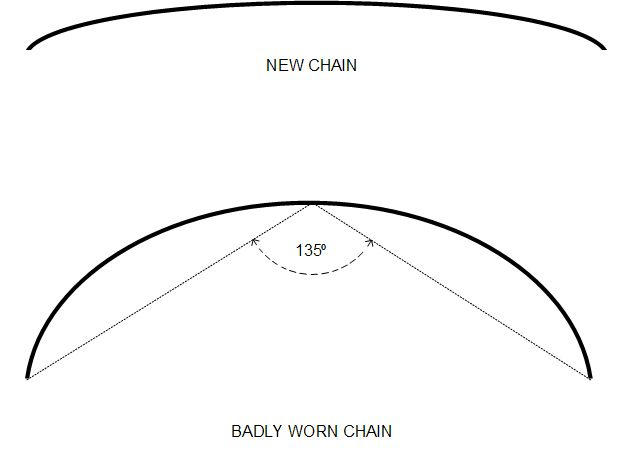

Regarding your chain, Scott, I'm inclined to agree with Davo's obs; although I like to check chain-wear off the bike, observing the amount of lateral curve it displays when laid out straight. A new chain offers a slight curve when laid to the limit that the rivets will allow, whereas a badly-worn specimen can display a 135º+ curve:
Err, that should read <135'; i.e. More of a curve.
