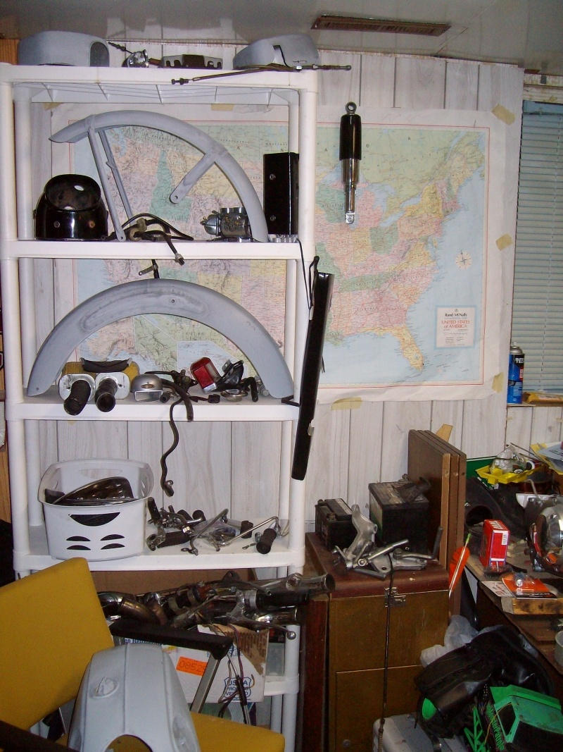

My son and I worked on it last weekend. He polished on the wheel hubs and they are looking great. I did mostly sanding on the primed tank, fender and side covers. My neighbor primed them at his body shop and he put a light spatter of black paint on it. I sanded it so it removed the black. I thought this was a cool idea, I learn something new every day :) It's ready for the top coat of paint.
I didn't plan to touch the front forks or light as they were in good shape. But since I am this far, I am going to paint these also. I can't wait to start putting it back together. I will post some pictures when I have something to show. Right now, I just have a bunch of parts :)

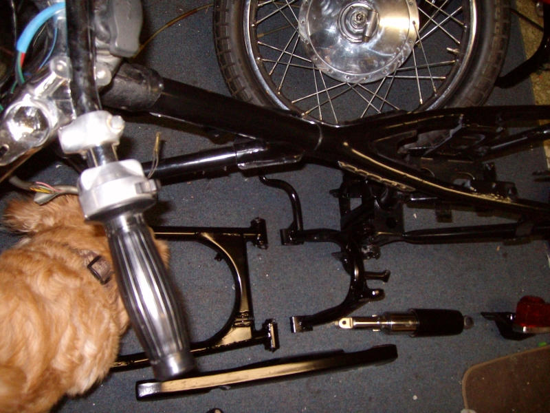

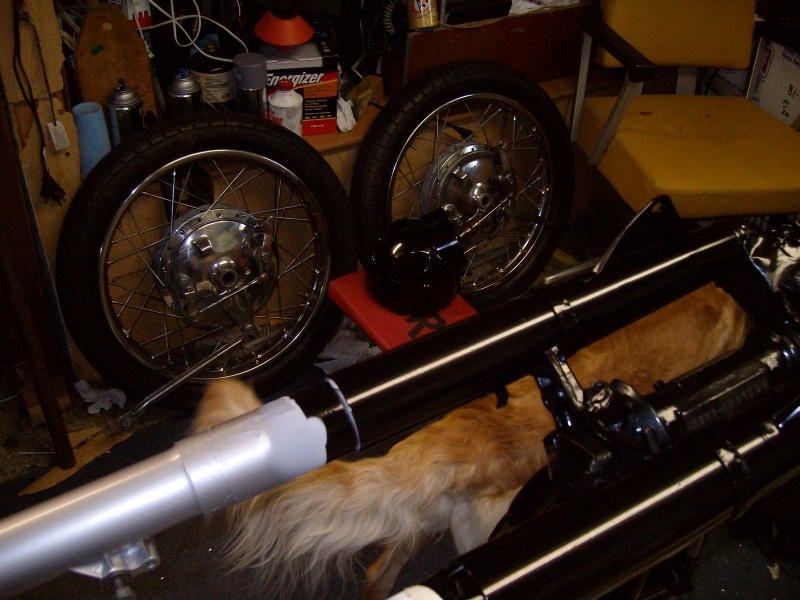

This weekend a little more progress. I painted the front end, and my son finished the polishing of the wheels. He took the tank, fenders and side covers to be painted this morning, so I am looking forward to seeing these when they return.
Attached is a in-progress picture of the front end of the frame, still masked, the headlight and wheels. And of course my dog who always likes to get in my pictures :)
