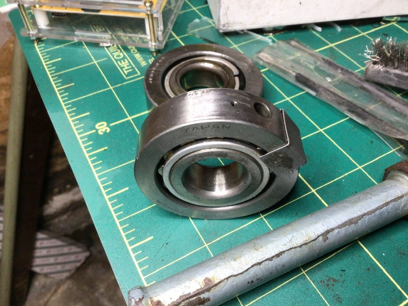

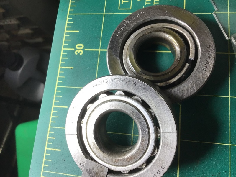

Geoff Hastings
Posts: 377
Location: Epsom, Surrey
Re: C95 bearing rumble
Post by Geoff Hastings » Sun Sep 24, 2023 3:35 pm
Thanks Tim, the bearings both have a locating pin hole and also has a small oil feed hole, unfortunately I’ve already bought the replacement bearings which cost over £200 for the pair. I did try my normal bearing suppliers using the numbers on the old bearings but with no luck.
