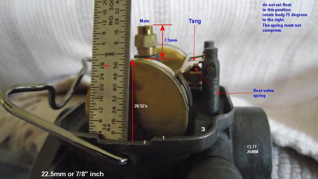

The trick described by LoadMouse and sketched by Deez seems handy, but just for my understanding, how to you measure the correct float level (see attached sketch)?
1. from the lip (heigher edge) of the body to the top of the float
2. from the gasket to the top of the float
3. from the lower body face to the top of the float
All of the above of course with the float arm just touching the float valve.
With:
- 26.5mm float height for 22mm carbs
- 22.5mm float height for 26mm carbs

My vote is for "3"......some others will say "1",...never heard anyone say "2".
There is another possibility......."3" but on top of the "Bead" that actually seals the gasket which is cast in the lower body face.
If you have a CB or CL with PW26's, just use LM's line of sight method, and don't worry.
If you have a C or CA.....the worry might always be present!

I did some measuring, and measuring from the top of the jet holder (method LM) to the top of the carb body (method 1) i get a bit over 23mm. So i assume method 1 should be corect.
Btw, i found out my floats were at about 28mm (making it lean) and my needles in the bottom groove (making it rich). I've set things according to the book, let's see how things workout with my repro-mufflers without dampers.

3! The metal Honda 'height gauge' sits in the recesses and measures the height from the gasket face on the body, not from the lip.mca2 wrote:The trick described by LoadMouse and sketched by Deez seems handy, but just for my understanding, how to you measure the correct float level (see attached sketch)?
With:
I cant say for 22 mm but.. PW26 is:
and the alternate method of "JUST see the bottom of jet" < dog dont hunt for me.
the Bill silver 7.5mm does play. i did it both ways to see if he was correct (pw26)
