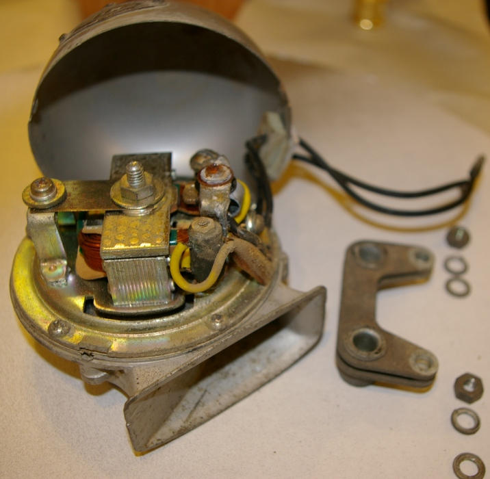

I wanted to take the horn apart for painting, to get a look at the electrics inside and to blow out the spider nest in the horn. A bit of sandpaper renewed the points and aside from cleaning, the rest of the guts looked fine and the horn worked at the outset anyway. The hardware is destined for the plating bucket.

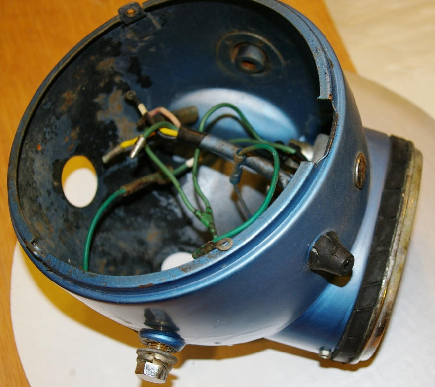

Looks like I will have to repaint the inside of the headlight bucket as well as the outside. I really want to not have to look at runny metallic blue paint any more...ever. Rubber something or other for the headlight switch knob?

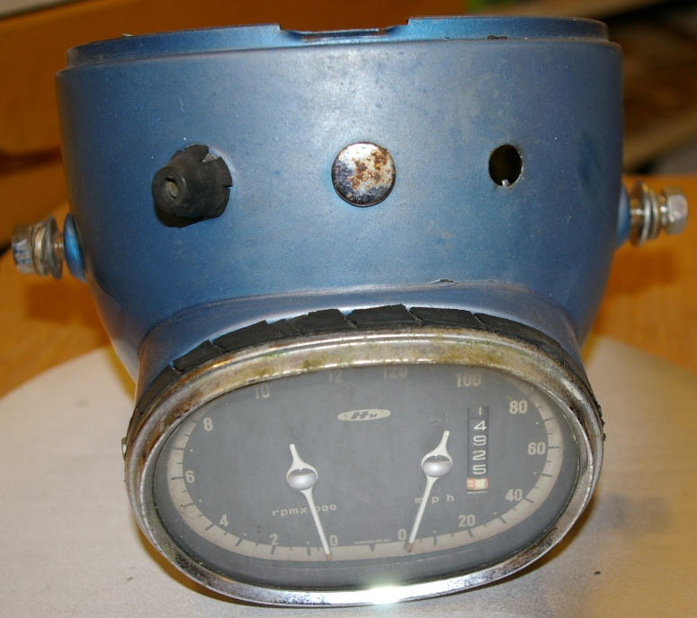

The hole on the right side looks original (I think for the neutral light), but I haven't seen any pics with a hole in the middle with a button plug like that.

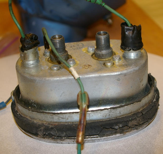

The boots on the speedo back-lights have melted? It's hard to imagine how that happened. And the speedo gasket will probably fall apart in my hands when I remove it. I haven't yet tried casting rubber, but when I do, this will be one of the first items to cast. In the meantime, some black foam weatherstripping will likely have to do.

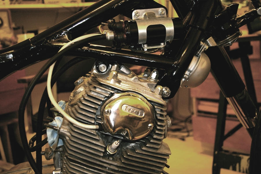

I just love looking at the shiny points cover and the newly painted horn! I thought about trying to remove the ding in the housing but I was wary of making it worse, so I've left it there.

Correct. Original lightswitch knobs can be found on eBay; I've also seen them on classic bike suppliers' websites.The hole on the right side looks original (I think for the neutral light), but I haven't seen any pics with a hole in the middle with a button plug like that.
I'd say a PO installed 4-Watt, instead of the required 2-Watt lamps, for a brighter light; I slipped some red butyl tubes, that come with some marine compasses, over my instrument lamps for a different look.The boots on the speedo back-lights have melted? It's hard to imagine how that happened.
