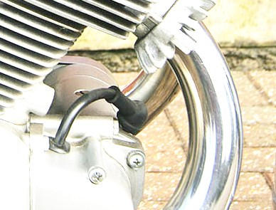

Post by e3steve » Wed Apr 29, 2009 1:56 am
I think Ed means the cover on the cable. That's not right.
If he says that's how Honda stacked the hardware on the stud, then that's how they did it. I'll be doing mine as per my intuition; from the starter body: as stated in my 1st reply.

Oohh, that. It was just how I got the bike. I looked into replacing it, but there doesn't appear to be a part number for just the rubber cover. I'd have to find the entire cable. If anyone has a spare rubber piece I'd pay a fair price.
e3steve wrote:I think Ed means the cover on the cable. That's not right.
Post by e3steve » Wed Apr 29, 2009 7:52 am
Scott, many electrical suppliers should stock the stud covers, particularly those who supply to the automotive, commercial (truck) or marine trades.
Print the pic and show what you need. It'll be a bit tight getting over the terminal lug, but a smear of Vaseline will ease its passage (ooo, er....madam!).
