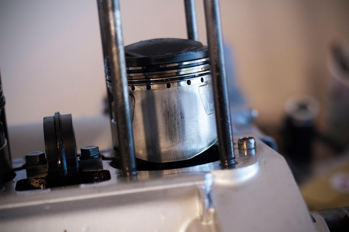

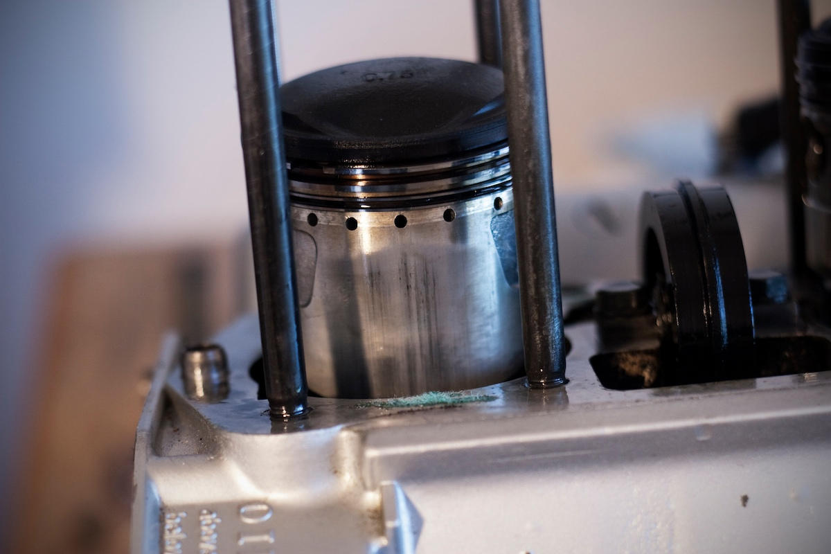

I don't wish to hijack Teazer's response(s), but I'd suggest looking for 'blow-by' on the piston skirt(s) -- a darkened, streaky stain, beneath the oil-control ring, indicating poor ring sealing.Spargett wrote:Teazer, is there a way to test to see if the rings are not sealing with the engine apart? I'm wondering if the engine wasn't broken in properly. I don't think I've ever read two break in guides that said the same thing. Would a new set of rings, and re-breaking it in fix it if that was the issue?

Good idea to pop the barrels off (argh.....) and see if a ring cracked when it all went together. Inspect the pistons for blowby and any other sign of things being less than new and shiny looking.
Another simple test is to pop the head back on and do a leak down test - no need to connect the cam chain etc for that one. As long as the valves are closed, it's OK.
If it's an oil ring problem it should be fairly easy to spot.

I pulled the cylinder and the inspected the rings. They all seem to be perfect. The ONLY thing I noticed after inspecting everything was these marks on the piston skirts. Reminder, the pistons were brand new when installed. The marking is more predominant on the right piston. Any guesses on what this looks like?
