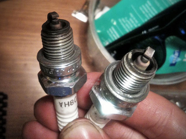

Right side showed just over 150 and the left showed 155. The plugs look pretty good, but could be a little better. I feel like the bike has lost some of it's performance. Lacking the get up and go it had, as well as the top end. Still trying to figure that one out. I've noticed the bike performs "best" (right now) all around when I set the timing dynamically to F at idle (never makes it to the full advance marks, about 65°-50°). If I set it to full advance (which the e-igntion recommends), the power becomes very lackluckster at all ranges. Slow to respond and has a hard time not really getting anywhere special. With timing set to advance idle falls about 15° ahead of F.

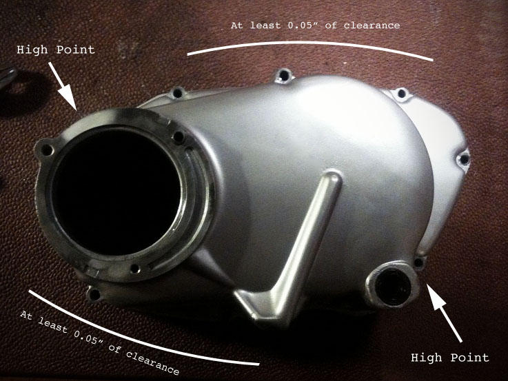

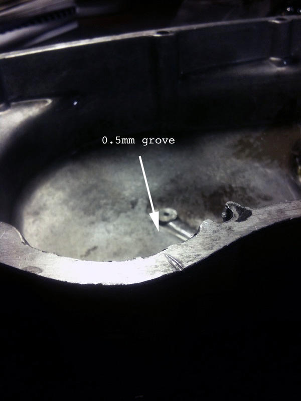

The second was the left crankcase. I should have paid more attention to the surfaces before I put it on. It was a used part I purchased and had never put it on before. There was a very obvious valley dented into the surface right where the leak was occurring. I also put the case on a plate of glass and took my valve feeler around it. There are two noticeable high points (see photo) leaving a remainder where I could slide the 0.005" feeler under the rest. I'm thinking a very very modest and light application of JB Weld to fill the valley, then slowly sand the entire surface of the case on the sheet of glass to flatten it out (like people do with their carbs).

Hi Scott,
Did you ever attempt something to flatten the way you described ? (and measured afterwards ?)
It seems easy, it's not, and I strongly suggest that you practice first on an old part.
The pressure from you fingers on the cover, the type of sand paper and the wiggling of the cover around the high points are very important in the end result.
Always move in a straight line, one way (change 180 degree once in a while). Make sure the longest axe of the part is in the same direction as the movement. Change direction (30 degree's) after a few times and look at the surface every time you changed direction, so you can see where the sandpaper takes off the material (crossed lines). Use 400 to 800 (wet) sandpaper with water and flush it regularly. Make sure the sandpaper is flat (glue it with spray glue over the whole surface, do not tape it).
The grove should be filled after the flattening process !, due to the difference in hardness toward the other material.
Apply a little pressure on the part in the centre of inertia, not on the edges. Just enough pressure to sand, not enough pressure to make it bend.
I saw many surfaces screwed up by people who thought it's an easy job, but having the discipline to do it in the described way will satisfy your needs.
You could also bring it to a machinist like Dave did, it's always better (when the machinist is knowing what he's doing).
Do you use a torque wrench for these bolts ? I suggest you do, because in most cases the lack of not using it will give you curved surfaces like this. After all, these parts were flat when left the factory,
