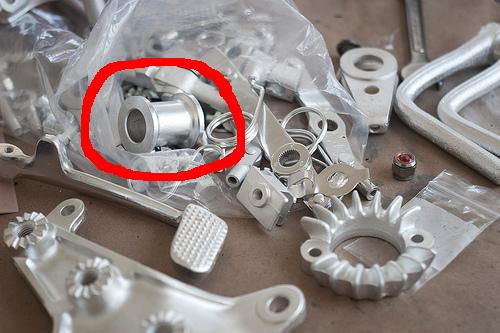

looking through the pics of your resto work, i have 2 questions:
1. is that a rear wheel spacer that's been turned down?

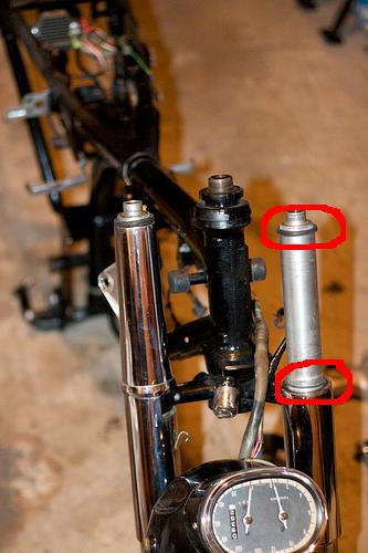

2. the top circle looks like the bushing that should be installed between the chrome fork rib and bottom fork cover, not between the fork bridge and top fork cover. the other circle...is that an o-ring on the fork tube?
