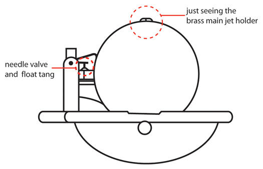

I have a simple way to set the floats on the CB/CL77 carbs. With the bowls removed and also the main jet I look across the bottoms of the floats and set the float tang to just touch the needle valve at the same time I just see the brass main jet holder. ...................lm
hello lm. i drew this quick diagram to illustrate your way to adjust the floats. im trying to understand it correctly, can you tell me is this is correct? if not can you inform me on how to correct it? thanks
Post by LOUD MOUSE » Fri Sep 05, 2008 4:56 am
Good drawing. Ya have it right. ..............lm

Thanks for the drawing! I'm a couple of cards short of a deck and didn't know what a float tang was.

So when the tang is JUST touching the needle you can JUST see the bottom of the mainjet holder.
THEN if you depress the float all the way to the carb body (without bending of course) the measurement from the notched lip of the carb body to the floats bottom should be 22.5 mm on a cb77 with square bowls?
