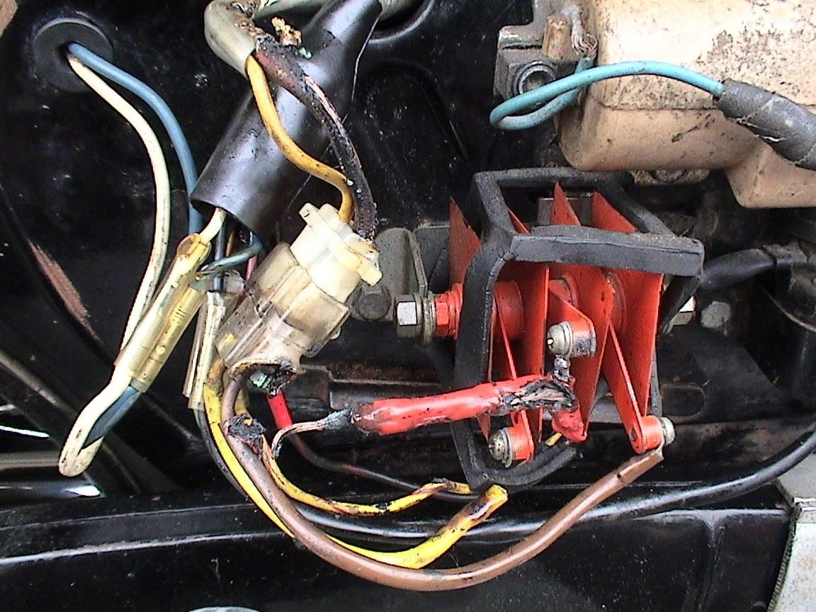

If your bike still has the OEM selenium-diode rectifier, then I'd recommend replacing it with a modern silicon-diode type (instructional topics and posts here, on the forum, aplenty) and/or installing a 25-Amp fuse in the charging circuit wire. The selenium recs have been known to internally short-out, thus causing nasty burney-outey results!

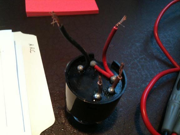

combination sw
attached a diagram of the combination switch as is and a photo of the back of the switch.

OK Ken, how many positions does the key turn to? Does it match the OEM switch?

reply to switch connections
key cannot be withdrawn in either position 2 or 3
continuity
Position 1 - no continuity (as you predict)
Position 2 - red>black, plus brown>brown/white (as you predict)
Position 3 - red>brown (not to brown/white)
there is no open stud but the red wire terminal also has a red wire jump to a fifth terminal stud
continuity

OK Ken, connections as follows:
I'm surprised that the key can't be withdrawn in position 3, as that's PARK and should now present the parking light & taillight. Crappy-cheapo AM switch! But, hey-ho, it'll work in all other respects.
The harness's colours should correspond to those I've mentioned in the above list. Should they not, please let me know what colours they are; but you should have:
G'luck!
- Connect unfused red wire (from rectifier +ve) to red/white from battery +ve (these are usually sleeved with heat-resistant material) via a 25-Amp fuse
Connect harness fused red wire to your ign switch red
Connect harness black (and/or black/white) to your ign switch black
Connect harness green to your ign switch brown/white
Connect harness white to your ign switch brown
- Red (fused)
Black (and/or black/white)
Green
White
G'luck!
switch and harness
Clearly you understand this stuff, and it is really helping me, one step at a time. I don't understand these points;
in position 2, the red connects to the black and the brown connects to brown-white but the brown and brown-white do not connect to the red. how would the power get to the brown and brown-white?
the harness is separated a bit, so that i have two harness elements present at teh switch
the following wires to available to connect to the switch:
one contains only a black wire that goes only to the coils
the other harness has 1) another black, 2) a green, 3) a 'thickly insulated' white which appears to connect to the rectifier, and4) another white which connects to the tail light and i don't know what else.
The original setup had a thickly insulated white non-fused wire from the battery connected directly to the brown-white switch terminal. In position 2 that would connect the brown terminal to everything else on the bike except the black wire to the ignition coils, so everything got power from the brown including the rectifier. Should i now connect the battery directly (through a 25A fuse) to the 'thickly insulated' white wire to the rectifier?
The wiring diagram is confusing to me in this respect. it shows a red-white unfused wire from the battery connecting to the same terminal as the fused red wire and also to the rectifier.
