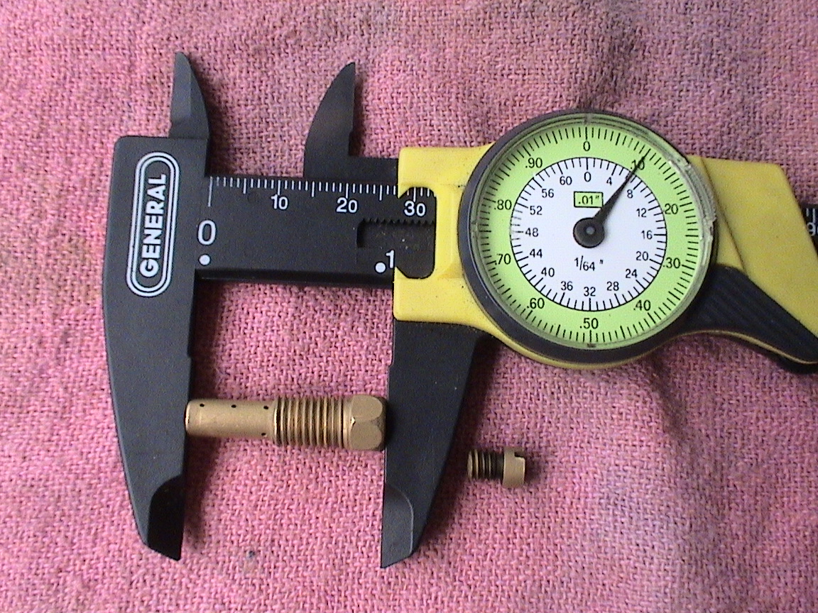

Here's a shot showing the measurement of a CA (PW22) Main Jet Holder for reference:
Since I don't have a PW26 carb to compare.....

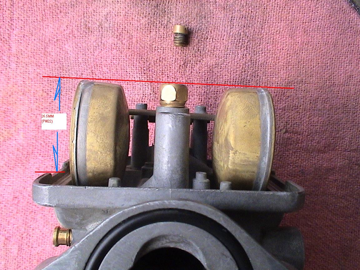

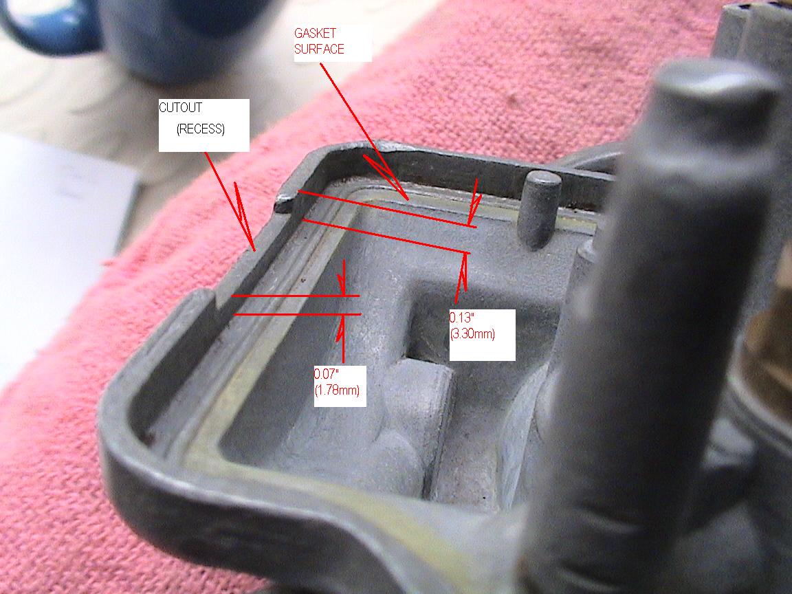

Post by brewsky » Sun Jul 03, 2011 7:27 pm
Interesting that IF you measure the PW22 float height (26.5mm) from the carb body recess (not gasket surface)....as Steve's float gauge shows, the float lines up with the main jet holder (jet removed), as with LM's method for PW26's.
COINCIDENCE? Or does this mean the height should be measured from the recess, rather than the gasket surface?
