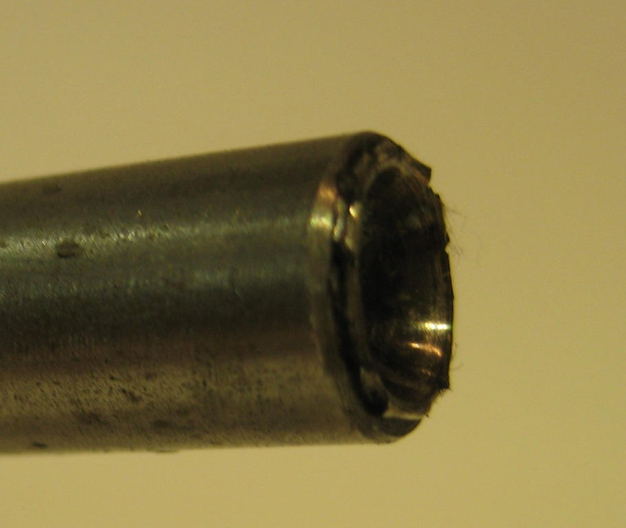

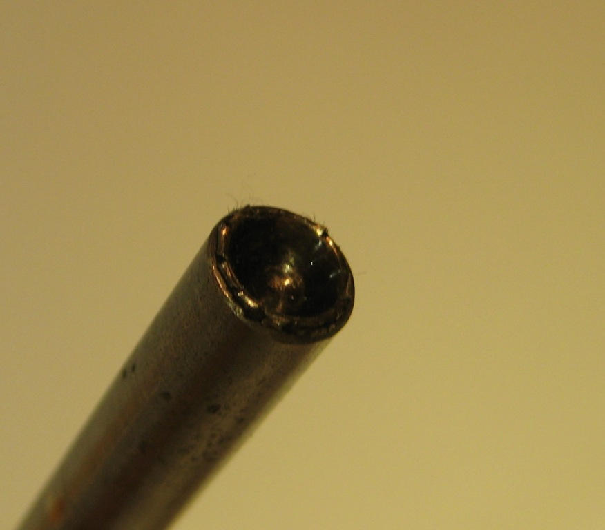

Pics of my homemade stainless steel lifter rod, no longer in use (obviously!), as promised. It did the trick for a season though. My NOS rod has taken me about 5 miles, so far, and is already exhibiting a tiny sign of indentation (albeit slight) from the ball bearing.Wilf wrote:Thank-you for your observation Steve.
Over the last few days I have thought about my shifting problem. I'm going to try eliminating clutch drag as a cause. After that, I may have to look at the clutch lifter rod end for "sick mushrooming".....Wilf
This rod here was the cause of my clutch drag. CB snicks in & out of gear much easier now.
