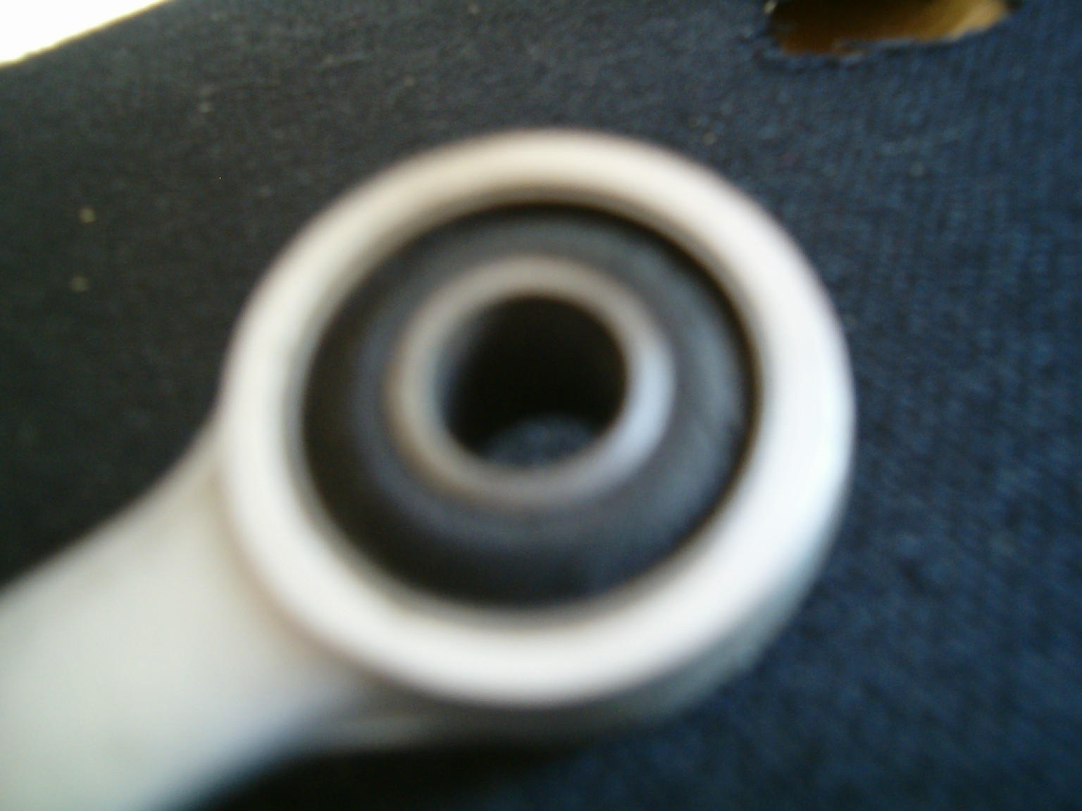

I have never seen one so it hard for me to visualize. So you are saying it is a steel sleeve that the bolt goes through and the rubber bushing that surrounds it? Do you know why is it made that way?

A pic is worth a thousand words. Hard to focus, but you can see the color differance between the silver alum., the grey steel bushings and the black elastomer. I have a 65 CA77 I am parting out. It has a fairly good set of bushes on it. If your interested Email me at d_johns@sbcglobal.net
As to why the bushes here and not the shocks. ????????
