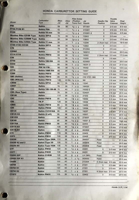

I found that the engine runs lean without the baffles so I have always just left them in. New baffles (diffusers) are available from the usual places should you want to install them. Otherwise you will have to play around with the carburetor jetting.
First I would try installing a pair of #140 main jets. This is a small bump from the stock #135s and will have most effect when the throttles are more than about 1/2 open. If this doesn't fix the problem I would raise the needles one notch. I have attached a file and linked to another with information that may be helpful.
