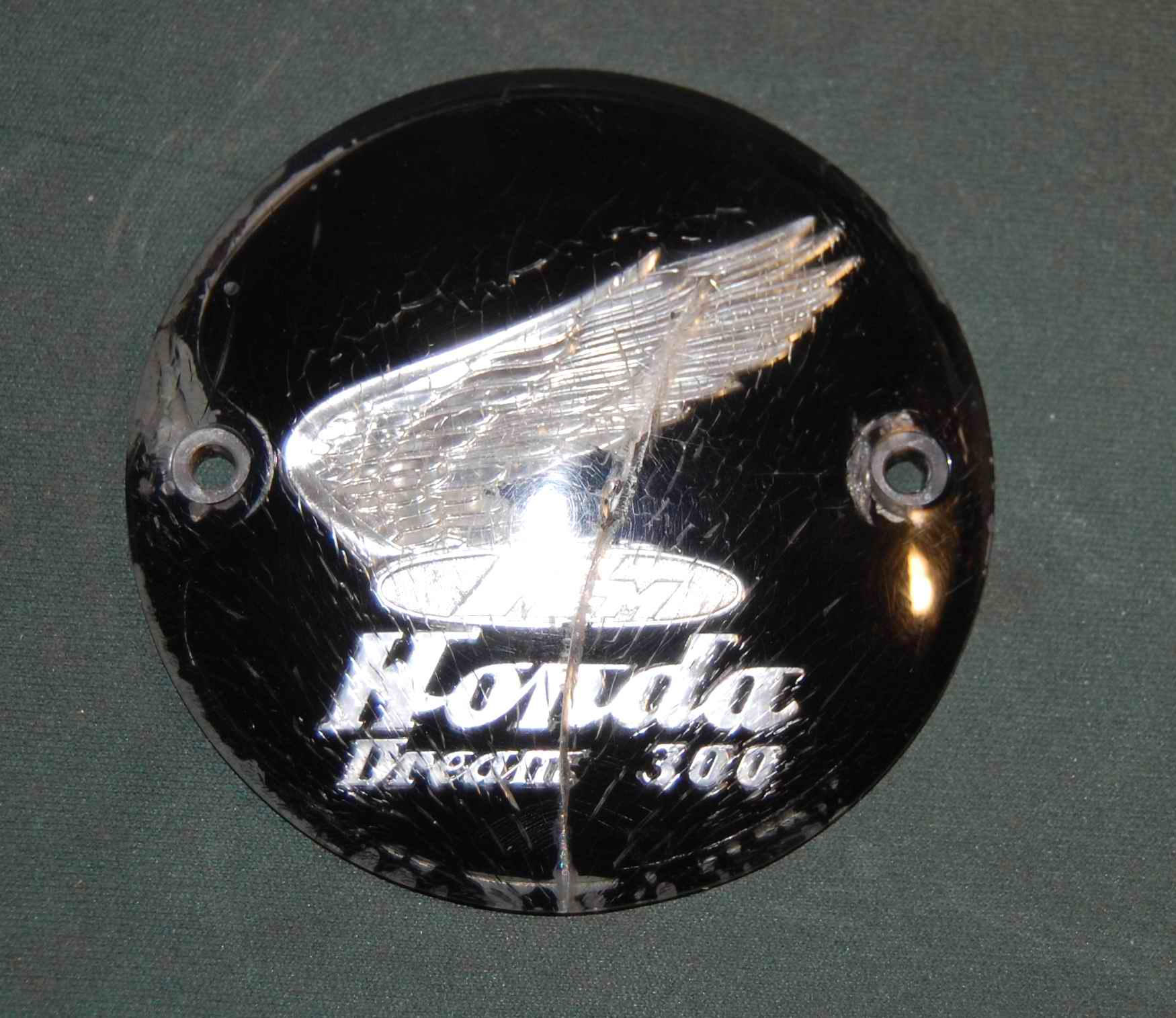

Hi Scott, I think we're all admiring your enthusiasm. Hope you won't mind a few unsolicited suggestions. #1, using the seach function above will help you find answers to many questions that have already been answered. Frinstance, search for "shocks," then go down to thread titled "chrome shocks anyone?" and you'll find one very bad review and one lukewarm one on those Thai shocks, plus some other alternatives. If yours are functional you might consider staying with them for awhile. Correct shocks are tough, I'm looking at $350 or so getting the "right" ones.
As another example, arrived at by a different method (searched LoudMouse's posts) I found that he first answered your question about breather vents and air cleaners on 9-1-05. And a number of times since then.
Re tank badges: I don't know about all '62 cb77s but mine came with "Dream 300" tank badges. Your frame number is only a few thousand younger than mine. There's a fellow who's just started making repro "dream 300" badges, can't find his email right now. If yours are original, just for later bike, and really worth $300, you could get $50 correct repros and net $250 for other stuff.
A couple more unsolicited opinions. A cb just doesn't look right without the "flipper" on the rear fender. Rubber part comes up on ebay pretty often, brackets (polished metal, unfortunetely, not chrome) are available from retrobikes. Also, if you wantta make LM happy and be "correct," paint your tailight bracket silver when you do rear fender. You might want to search this topic as well, there's been lots of discussion. Guess we'll have to forgive you the chrome front fork covers, they look too pretty to repaint just to be "correct."
All that said, I know the experts enjoy gnawing on tough problems like your cl kickstarter, and are happy to help. Hope I'm not out of line putting in my two cents worth here. Nice pix on Flickr, btw. some bordering on "art." Thanks, Lee
Yours don't look so bad next to this poor ol' thing, my only survivor. I'm going with repos, I guess this'n will go in my "precious junk" box.

Excellent info. Thanks Davo and jleewebb, I don't mind any suggestions at all. I'm here to learn, not to judge. Thanks for the info as well. P.S. Man, those badges have seen some action!
