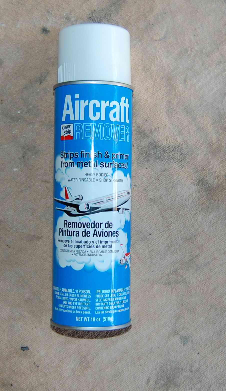

I thought I was going to be able to prolong getting the tank repainted, even though there was some damage from trying to remove the rust inside. That was until today when I set it down to open the garage door and it decided to roll down the entire driveway into the sidewalk.
Hence, time for new paint. The stripper that's on there is pretty mediocre stuff. It was highly recommended by an employee at Ace Hardware. Its a gel, which makes it very difficult to apply because it comes out more like globs of jelly. Then dries very quickly causing the slightly bubbled paint to re-harden. I'm going to pick up a different hardcore stripper asap. Any recommendations?

Aircraft stripper, available at Kragen auto parts works excellent, and comes in a spray can so it's easy to apply. Aroung $8, so not cheap, but very effective.

Post by jleewebb » Wed Feb 04, 2009 9:50 am
This is the stuff! Klean-Strip Aircraft Remover. I got it at store where I bought my paint, a DuPont distributor. Not cheap at $10.55 but it actually gets the clear-coat off the hubs and other polished aluminum, which none of the other three strippers I used on painted parts would do. I'm too chicken and in too much of a hurry to get bike rideable to mess with re-spoking the wheels so I'm just going over rims with steel wool and motor oil (LM's suggestion) which gets off about 80% of rust and doesn't look bad from a few few feet away. I have to keep telling myself this is a rider, not a show bike, it doesn't have to be perfect. Leave some fun for the next guy in 15 or 20 years. (Assuming I'm ready to hang it up when I turn 85.)
Attn. experts: should I clear coat those rims when done to prevent future rust?
Thanks, Lee
