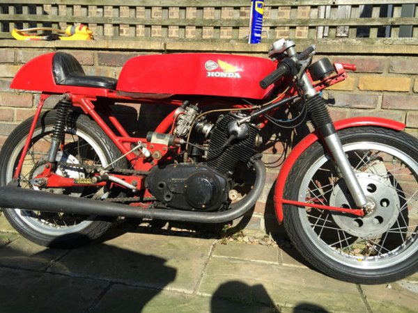

AlanW wrote:Look's great Dave, a job well done .
Thanks Al...Far from perfect to be honest, but she is a lot better condition than when I got hold of her.
The proof will be when we try to firer her up. Fingers crossed for that one.
Dave

First Fire Up after Re-build
Post by lloydy1 » Sat Apr 08, 2017 11:02 am
After a little disappointment for me and AlanW last weekend she finally came to life today. Thanks to all for your help and guidance. I have posted a link below of a little video of her coming to life.
https://youtu.be/vRxI3uHxryo
Dave
Posts: 5681
Post by G-Man » Sun Apr 09, 2017 5:14 am
Sounds pretty sweet! Welll done!
