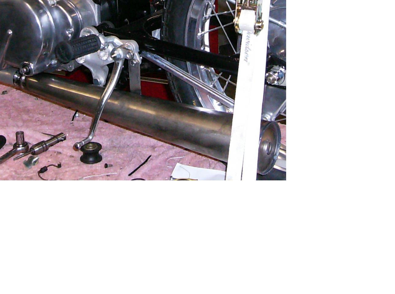

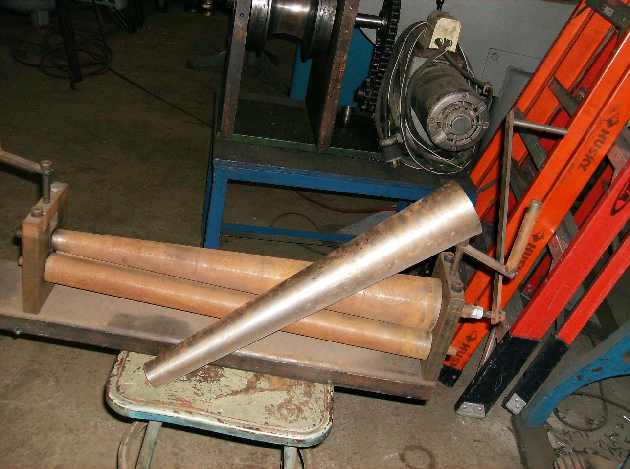

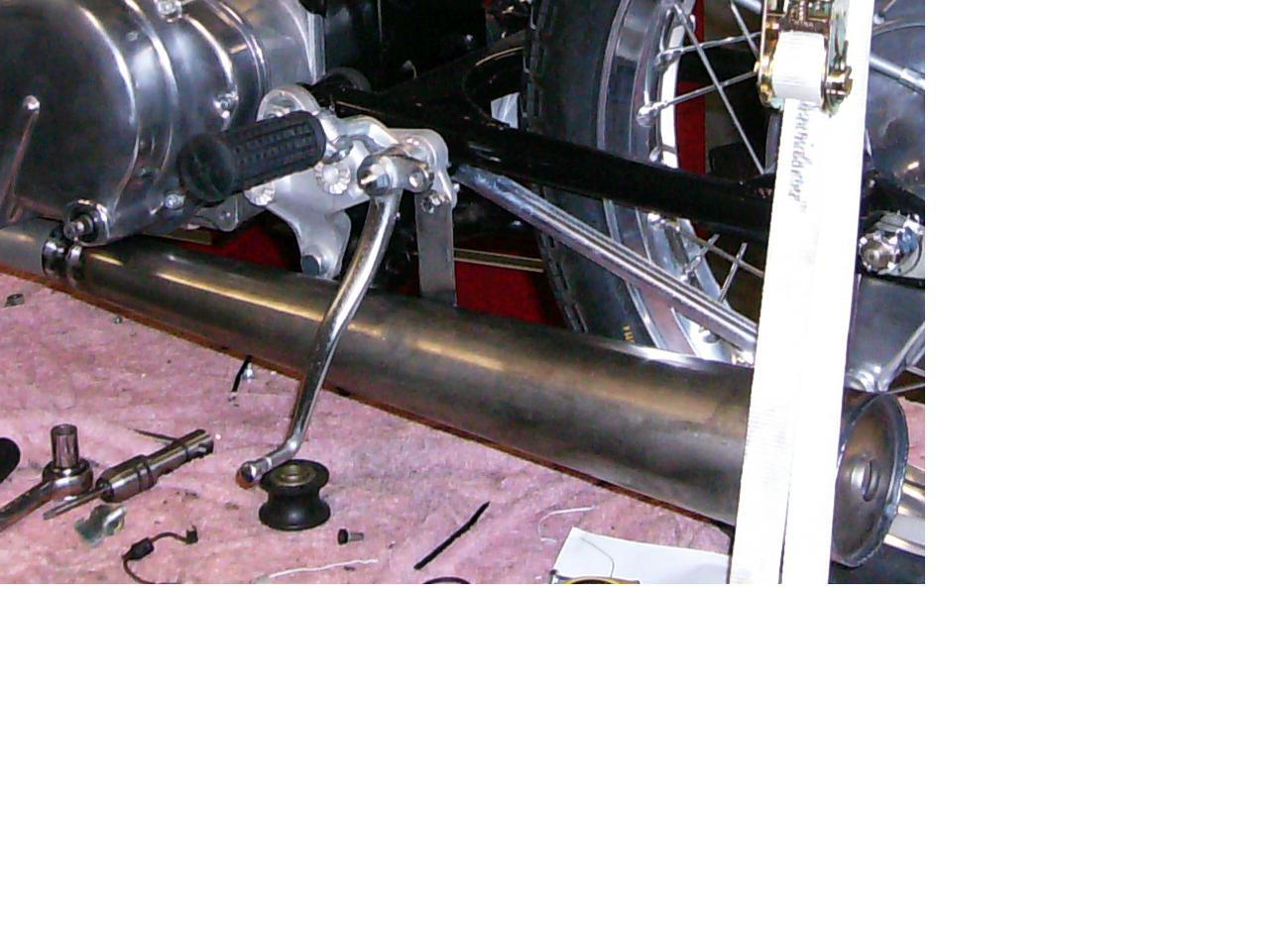

I have a custom "cone roller" that I built a couple of years ago to roll the Harley Scat mufflers. They are capable of max 26" length, min 1-1/2" id small end, and 3-1/2" min large end--20 ga Mild Steel.If someone can get the correct dim's, I'll roll up a set and we'll try them out.
I've got a set of the Harley Mufflers, double wall and with (2) 1" id internal disc' and no baffle, on my little custom road racer. The bikes pretty quiet but still open enough to run 145 mains in the carbs.
Mark

Actually thats just the cubbie hole at the shop where I keep my special projects. I'm in the machine and fab buisness and do a few bike parts on the side. The machine in the background is a rolling machine for fenders. We've done pretty much all the sheet metal for the Harley Humers including fenders,fork panels, etc. I may tool it at some point and run front fenders and braces for the CL's and CB's if nobody else is repoping them.

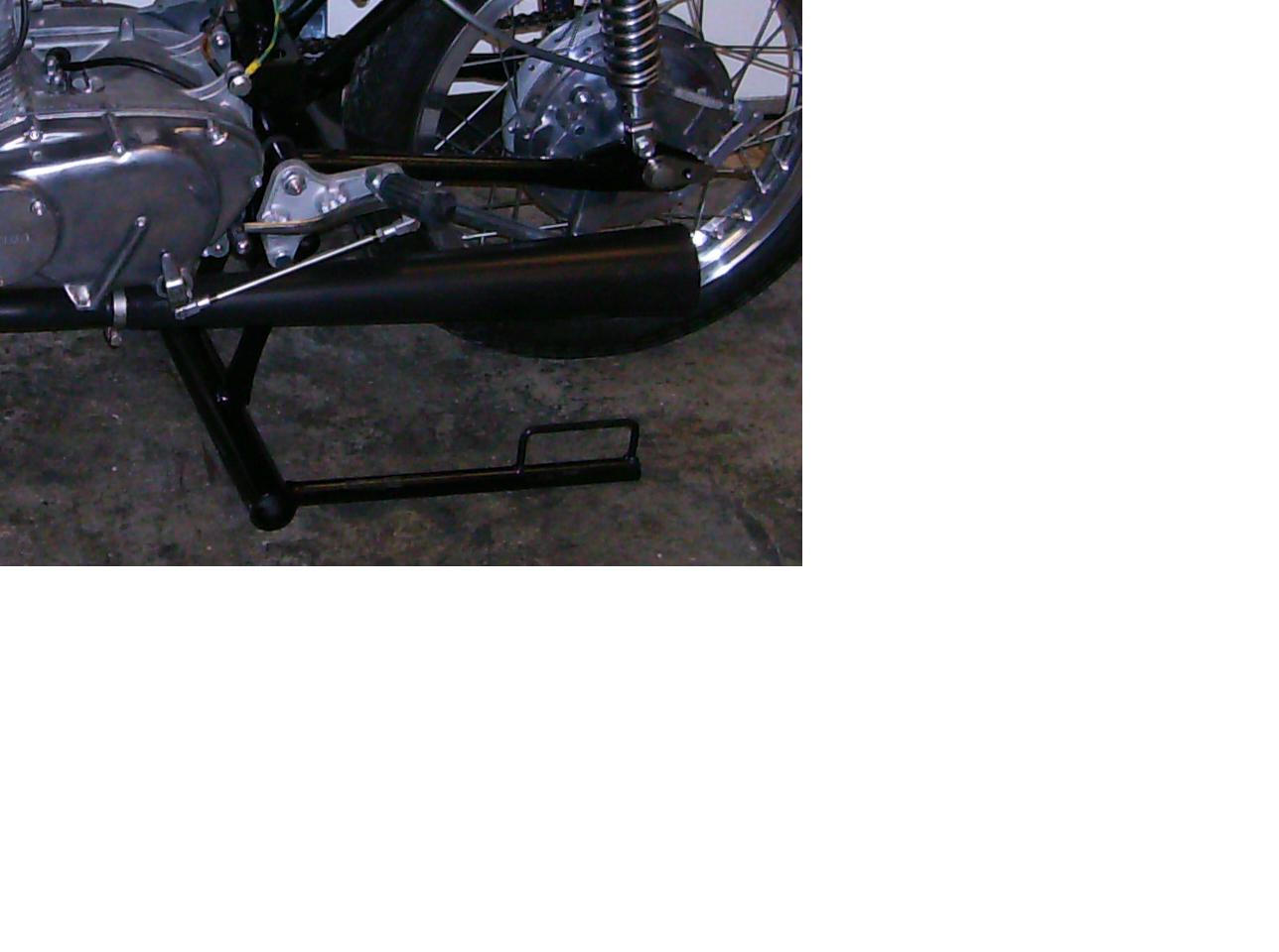

Post by Superchicken » Wed Dec 15, 2010 8:22 pm
make some pipes like this,
