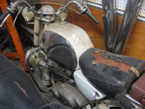

hi every body I have this old cp 77 police from my grandp

I haven't restored mine yet, but we can trade stories, parts, etc! Yours is the first I've seen with the square signals! I have the parts manual, shop manual, etc. Great bike! Paul

You have a good motorcycle mine it´s not restored yed but i have the siren and the front bumper ,and of course the stay patrol light, red color was made it for the fire department in Bolivia, Sud America

P.S. Forgot to say what A great bike you have there and now that I have my 68 305 Dream tore apart your bike gives me some ideas I would like to use like the seat and luggage rake.

randy wrote:Thanks for the reply this motorcicle still is mine and works for the fire departament in the early 60th and 70th and my grandpa buy it in the 73 its one of the motorcicle family still runs well only one major repeair was done the original pistons change the bore and the stroke from honda xl 185, incredible but works like a clock.
