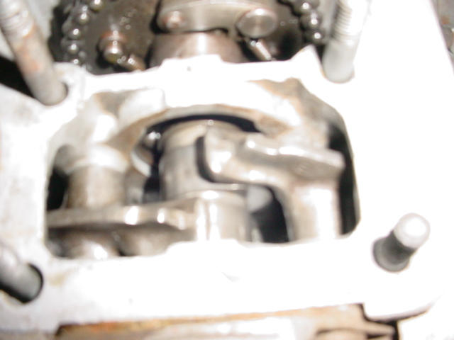

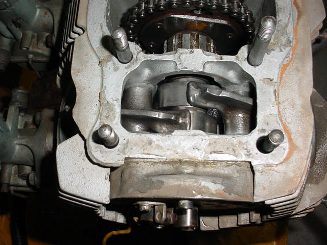

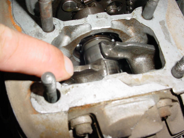

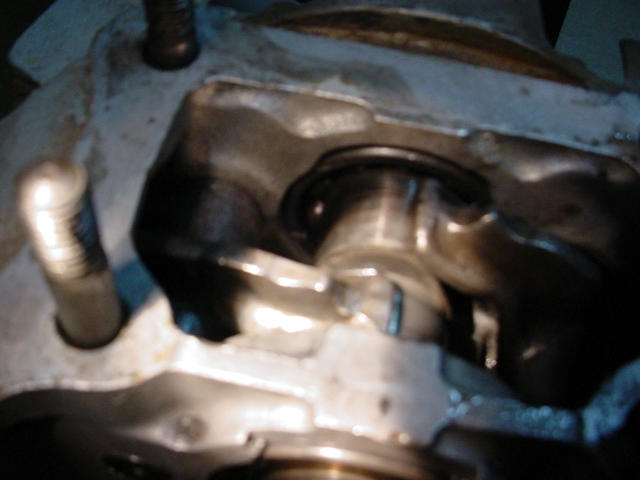

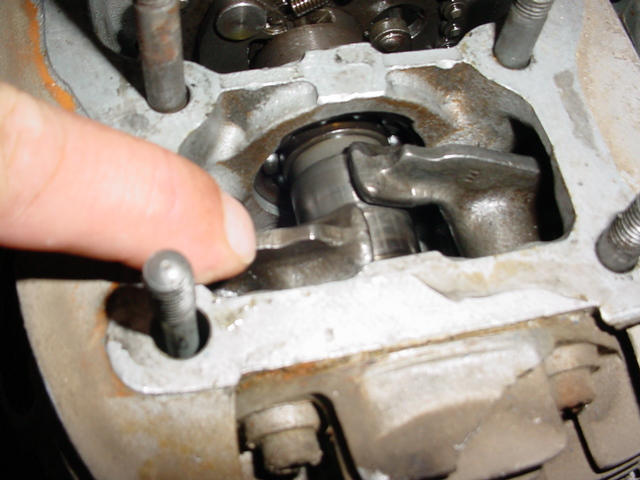

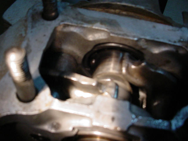

can someone take a look at the shots of the rocker arms do they look shaved for clearence? cam lobes are clean on the sides . maybe machined?

more
Post by thumper2146 » Sat Sep 18, 2010 11:12 am
here are a few more
Posts: 7817
Re: more pic's of the water cooled cb72 and questions
Post by LOUD MOUSE » Sat Sep 18, 2010 11:46 am
From I can see of the sides of the cams they look to have been built up and then machined.
The cam followers look to be stock. .......lm
thumper2146 wrote:can someone take a look at the shots of the rocker arms do they look shaved for clearence? cam lobes are clean on the sides . maybe machined?

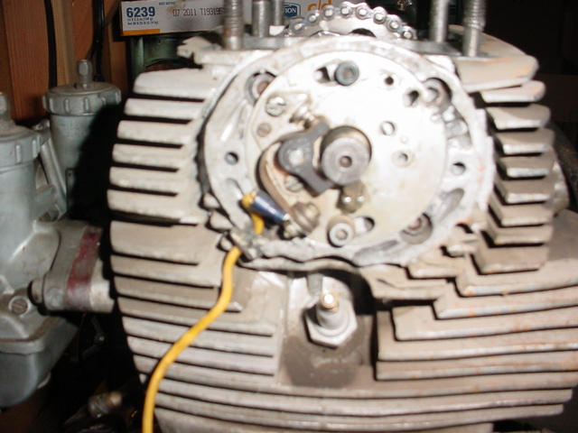

tune up and timing on this engine
Post by thumper2146 » Mon Sep 20, 2010 11:35 am
so i would follow the procedure on tune ups for a honda dream??
Post by davomoto » Mon Sep 20, 2010 8:23 pm
Thumper, pull the plugs, and see if the pistons rise and fall together. It looks like a twin points plate with one set of points removed. Are you tearing in any further, or just planning to see if she'll run?
64 CB77
63-7 CB77 Cafe'
67 CL77
64 CL72
66 CL77 big bore flat tracker
Many others!
thumper2146
Posts: 123
Joined: Fri Nov 16, 2007 1:29 am
Location: santa maria calif.

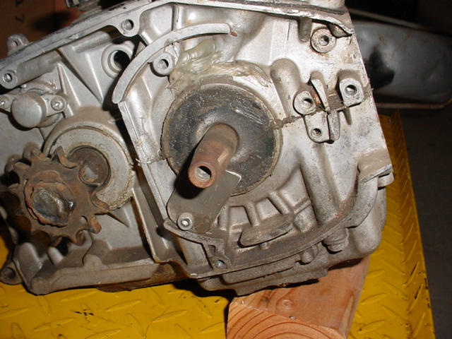

Post by thumper2146 » Mon Sep 20, 2010 9:44 pm
Hi Dave the pistons go up and down together i am thinking of trying to get it running but will have to put a rotor and electric starter on it first along with a stand. the kick shaft was cut.
the one set of points is/was hooked up to 2 coils
James
Post by davomoto » Tue Sep 21, 2010 9:09 am
You'll have to change that right crank seal to accept the starter sprocket. It will be interesting when you fear into it to see what other custom parts await you inside. I'm always hoping that one day I'll find a five speed hiddden in a set of old negleted cases!
