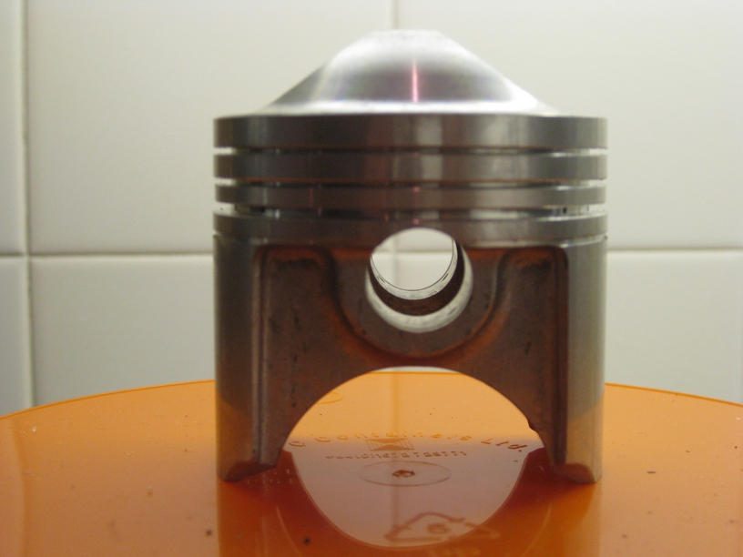

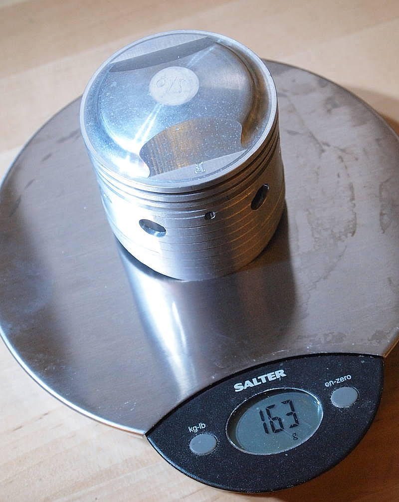

Stan
This is a Forged True 64mm which is the same weight as a standard CB77 piston but looks a little fragile. I'm either going to use these or some machined CB350 pistons in my conversion...
Hepolite made some copies of these at one time.

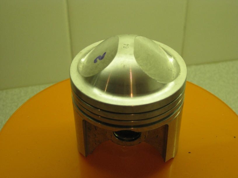

Hello Stan
I have attached some pictures of the Italian ASSO race pistons just for intrest, these were brought in to the UK by Dennis Murfin over a number of years, unfortunately I think he stopped importing them when the demand for CB77 race stuff slowed up here. They generaly have to race with the 350K's etc. now and even with a lot of time and money I dont think they can be compeditive (no doubt the short stroke,6 speed ones would be but that's another pile of time money altogether ! not to mention engineering skill)
Anyway the one in the pictures is of the later type, the earlier ones used 350K rings these use thinner( Kawasaki 600?) ones and have some other detail changes, the downside with them is they are a bit old fashioned ,tall dome etc. the up side is they fit well with a little squish work on a 72 head, have all the correct valve angles etc. already there.
By the way they are a lot stronger than the CYB350K ones that you mentioned I have only seen a few of these (with and without the holes in the sides) and they were all cracked !
Good to see the pictures of your 77 racer are you keeping the Honda footrest plates or are you planning make " loops" to mount them on ? you see a lot of broken /cracked std. ones. I still have a set with the serrations milled off which I used on my CYB kit bike at one time.

Gordon,
Thanks for the photos of the Asso, nice looking pistons, but I agree, they do look like the RSC? piston, (I'll post photo) with the large radius squish area. I have had great success with tuning the 350K's, and other bikes, by closely matching the head squish to the piston squish. Better combustion through turbulence, reduced ignition timing, and no need for twin plugs in the combustion chamber. All tested on the dyno.
It is relatively easy and affordable to have Wiseco Pistons make a custom piston. The basic procedure would be to build up a 64mm 350K piston with metalized epoxy, machine to your own specs, and have the dome replicated onto one of their existing forgings. Wiseco would select an appropriate ring set from their catalog. For example, the Todd Henning Racing pistons use a forging and ring set for a CBR600. (At least the last that I heard)

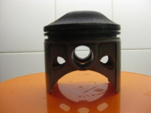

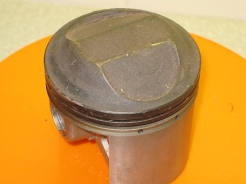

Hello Stan
Just a couple of pictures of a well used ( two welds and at crack ) RSC / CYB 350K piston so everyone can see how fragile they look and are.
