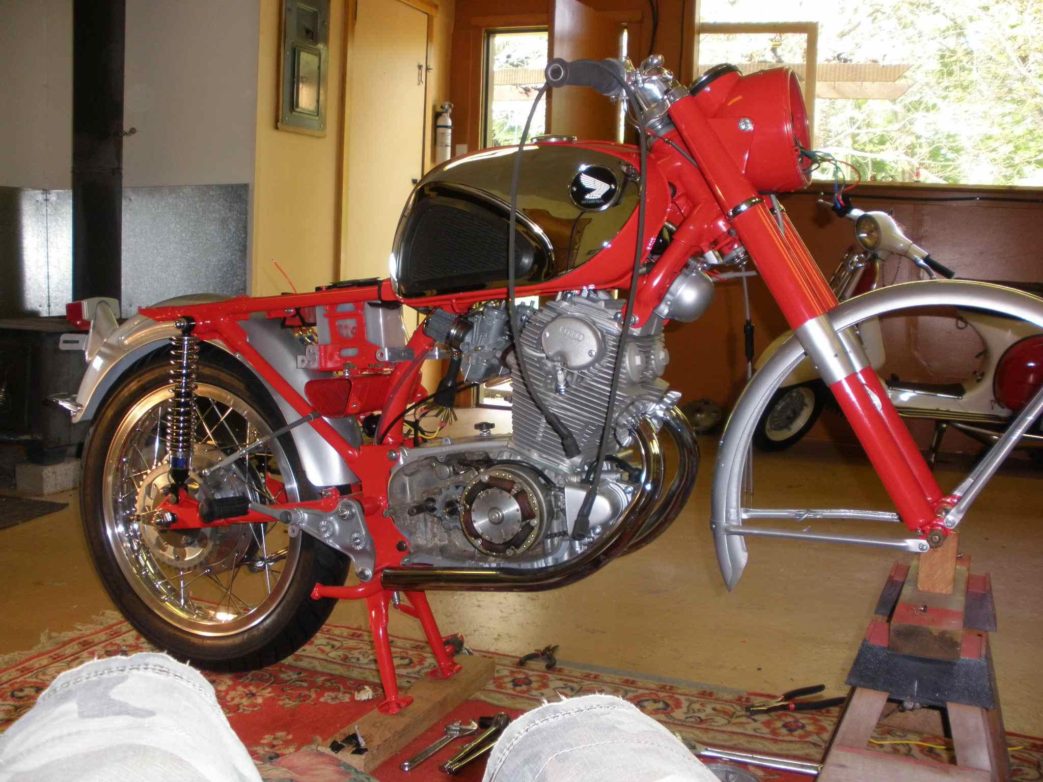

Nice job eyhonda, I'm about to install the same mufflers that you have and it looks like you have cut the headers shorter ( or just slid them into the mufflers a bit ) so that you can mount them to the frame attachment points. I was going to mount the attaching arm to the rear hole in the footpeg bracket but now I'm thinking that maybe that's not so wise as it's alloy....any thoughts on this? Thanks

@ Maia; I had the same concerns about the mounting point on the footpeg bracket. Also, being mounted at the frame lower point, it is more hidden. I had to cut the bracket down since it was too long. You can adjust the mounting position better with more flexibility. The mufflers were just pushed on the head pipes, which I got from Nick at Ohio Cycle. I marked a point 2" from the end and just pushed them to that mark. The left side is a bit lower due to the interference with the shifter linkage. You can't tell unless you looked real close and compared the mufflers side by side or maybe from the rear. Well now that I compare my pics and yours, I think my headers are just shorter?? That's OK, the ends are just where I want them. Not too long.
