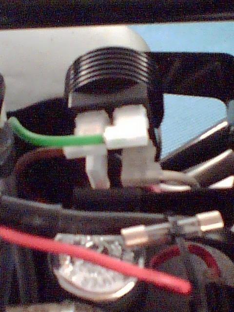

2. The second improvement has been replacement of the old (but not original) 15A(?) selenium-diode rectifier with a 25Amp Schottky-diode type (I know some have already carried out replacement, predominantly with a silicon-diode type from Radio Shack, with great results) -- my pic below. The rec and heatsink are http://uk.rs-online.com/web/search/sear ... m=629-0041 and http://uk.rs-online.com/web/search/sear ... rm=103-960 respectively; I drilled the heatsink and locked the rec to it using an M5 x 40 machine screw.
The rec has the advantage of a low forward-volt attenuation of 1.1V, as opposed to the selenium figure of circa 3V. There is no evidence of overcharging as yet, as I haven't needed to top up the batt's electrolyte.
Charge current before this change - @ 4000rpm, : 13.40V / 2.8A, parking light on
And after - @ 4000rpm, : 13.65V / 3.0A, parking light on
Now, I realise that these increases are relatively small-beer, but time and extended use will tell. I'll keep you all info'd. I've only made short excursions before testing yesterday, the voltage and current measurements being carried out using Fluke calibrated DMM and clampmeter.
Sorry for the quality of the photo; I have to use my 1.3Mp phonecam now that Cowbag has left and taken her Sony camera!

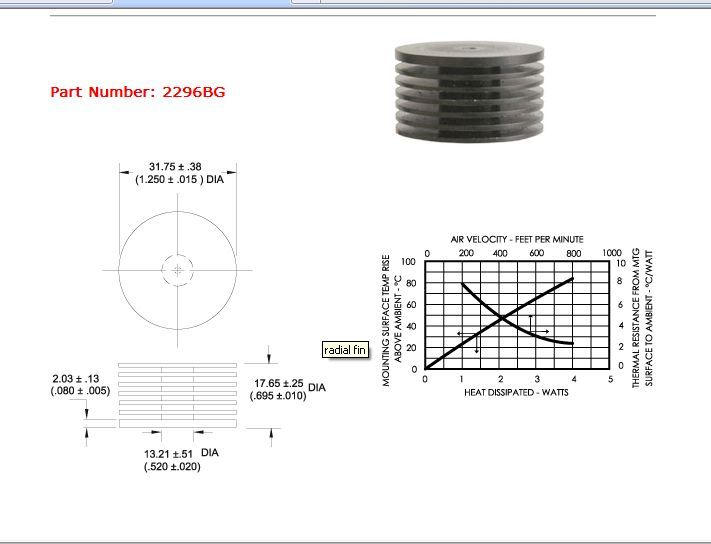

Post by e3steve » Tue Aug 12, 2008 2:19 am
It's made in the US by Aavid Thermalloy and is part # 2296BG at the bottom of the page here:
http://www.aavidthermalloy.com/products ... dial.shtml
Click on Find Distributor in the Useful Links pane.

First of all, great writeup! Second, I have two questions, one on topic and one off. 1.) Is the heat sink necessary? I recently purchased a silicone rectifier from Oregon Cycle and he states a heat sink isn't necessary. I am wondering how true that is. I am almost done with my resto and I will be using the bike as a daily rider and would hate to have issues right after I get her running. Here is a picture of it mounted.
