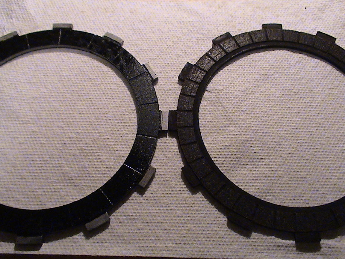

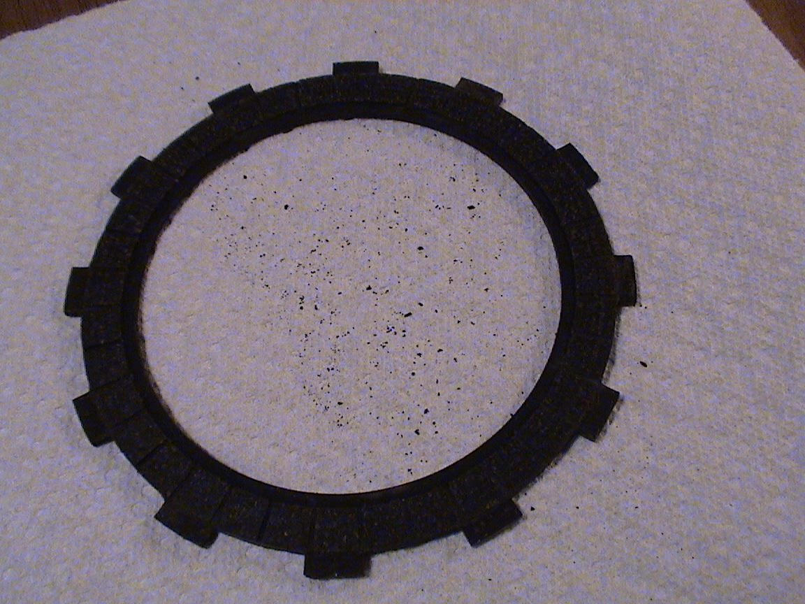

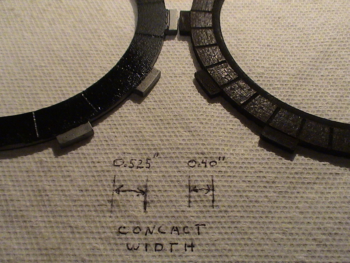

Got re-furbished friction plates today from Loud Mouse and they look much better than what I removed!
The metal core friction plates have much more contact area than the all fiber version.
I had tried cleaning the old all fiber plates but they started flaking so I was afraid to use them.
Pics showing the difference below:
