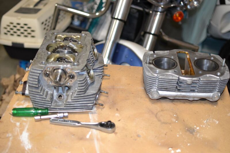

Geoff - I had a little catch in my heart when I read about your accident with the angle grinder. What an angry little tool. I too have learned to listen to that little voice that says, "You shouldn't be doing this. Something bad is about to happen." Learned it more than once I'm afraid. It sounded bad enough but I'm glad you weren't hurt worse. Progress on the project: Got the jugs and the head back and machinist says they are ready to go. I ordered some of the cylinder head washers from Partzilla. Not copper but I trust they will work OK. Finally broke down and bought a jug of Evaporust to see if will work. I put in a gallon and have been rotating the tank. I think it is working! Cleaned up and evaluated the handlebar controls. That little metal ball is a bugger to get back in and I wasn't real sure which side of the mechanism it fit. Now I'm researching options for heat shrinking the wire(s) from the controls. The original shrink wrapping, cables, etc., were beyond bad. Set aside the Scrambler handlebars that came with the bike and put on a pipe handlebar. I like that look better. Now that the motor parts are back that's what I'll tackle next. Any comments or advice is greatly appreciated.

I don’t use shrink wrap up to the handlebars as once it’s shrunk it becomes quite stiff. I bought some excellent silver grey adhesive tape which five years later still looks good and is flexible. If you can find the flexible plastic tube they used originally then that is best but difficult to thread the wires through them. The small ball in the switch usually fits into the sliding plastic thumb control, it does have a small spring behind it so a bit of a fiddle to reassemble but achievable. I would still try and get the copper washers as they help with the oil tightness on the head, don’t forget they run oil up the cylinder stud so make sure you use domed nuts, you can anneal the original washers if you really can’t find replacements.

Back to Bill's project: If the original washers are copper, I would be wary of using another metal because of different expansion rates.
