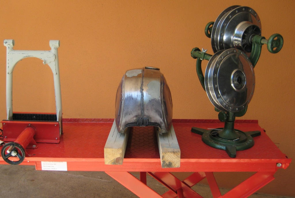

Replacement hubs are polished, lacquered and the drums have been skimmed to 'true' them; ready for wheel building with the Union Cycle rims and new cad-plated spokes.
I bought a tank to work on a couple of years ago -- nothing wrong with mine, crazed paintwork aside; I just want to be able to continue riding whilst renovating -- and I stripped the metallic paint (over the top of the original blue) only to find two areas bogged with pudding. They'll need to be made good before going any further.
I also have a replacement swingarm, NOS from Japan but starting to rust a bit from 40+ years' storage, undergoing prep -- once again, nothing wrong with mine other than a PO had tack-welded a makeshift chainguard bracket in place...... the wrong place, and only one screw tag! Then he/she went to a great deal of trouble and expense to have it, along with the entire frame, powder-coated.
One thing has bubbled to the surface during the past week of paint-stripping and rubbing-down: the really shoddy factory-applied paint process; no primer -- it's colour straight onto bare metal! The tank sides, under the chrome panels, are original and untouched; the swingarm is genuinely NOS with no sign of a wheel ever having been installed and with the paint still intact within the threads, but the application of the original paint is the same: straight onto bare metal with no primer.

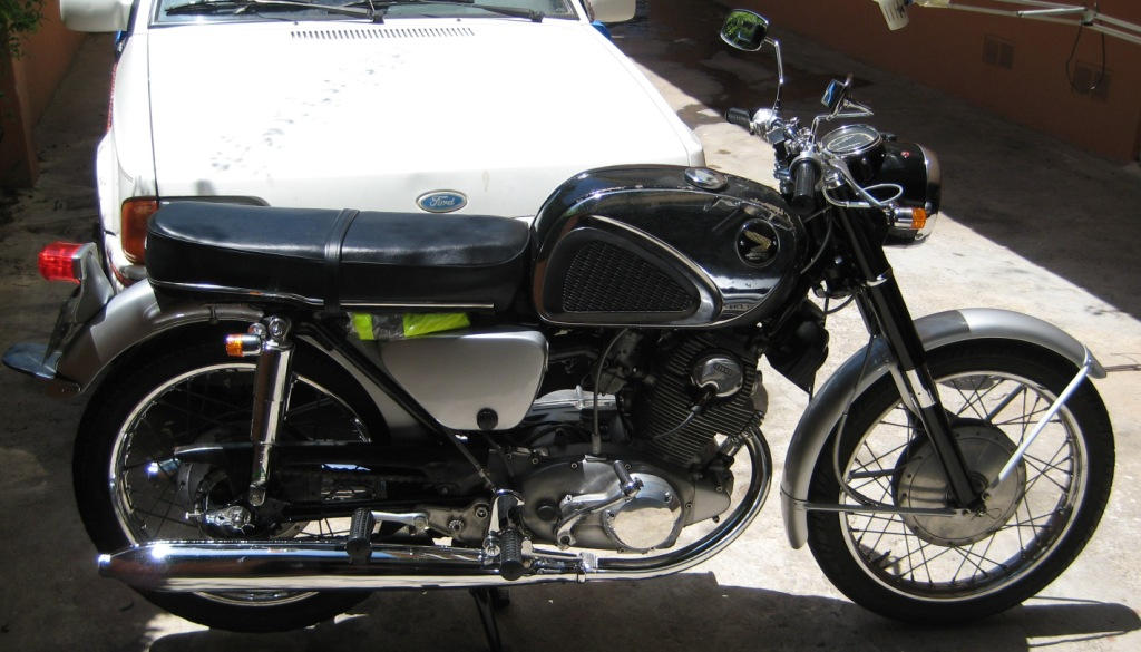

I decided that a full resto was going to render the bike too precious (or, moreover, make me too precious over it!) so it's more of a refresh with restorative overtones along with improvements. Because of its mish-mosh assembly (the '61 'old style' CB72 frame) and the fact that I like to actually ride it regularly, a 'refresh' makes more sense. So that's what I'll call it.....It'll never be 'show' or concours;

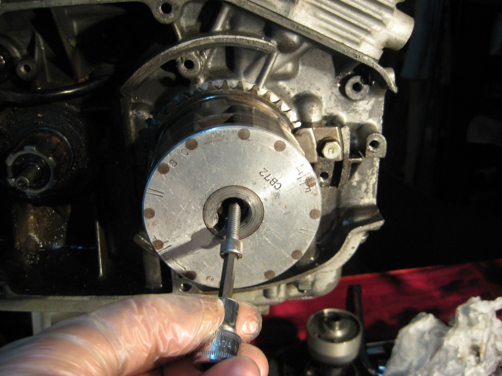

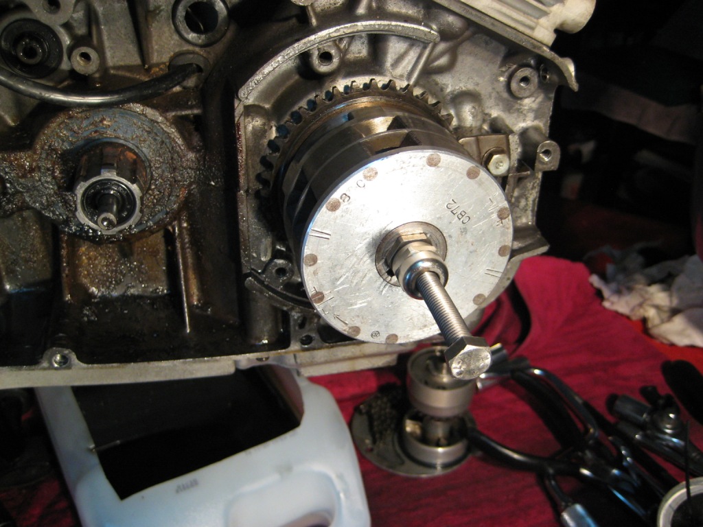

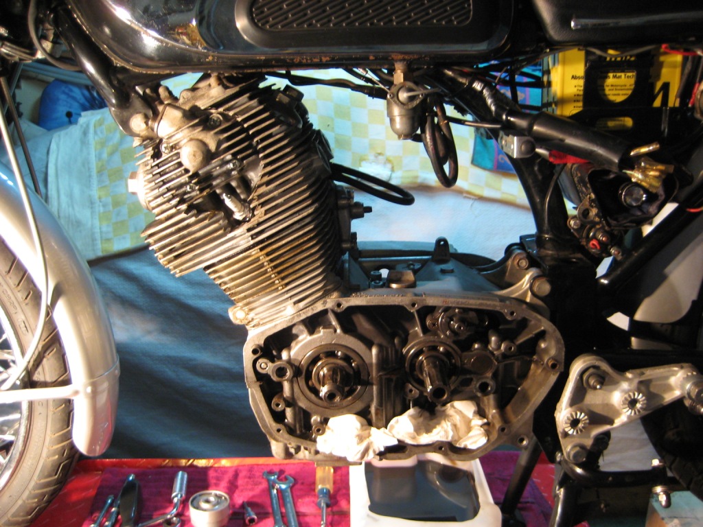

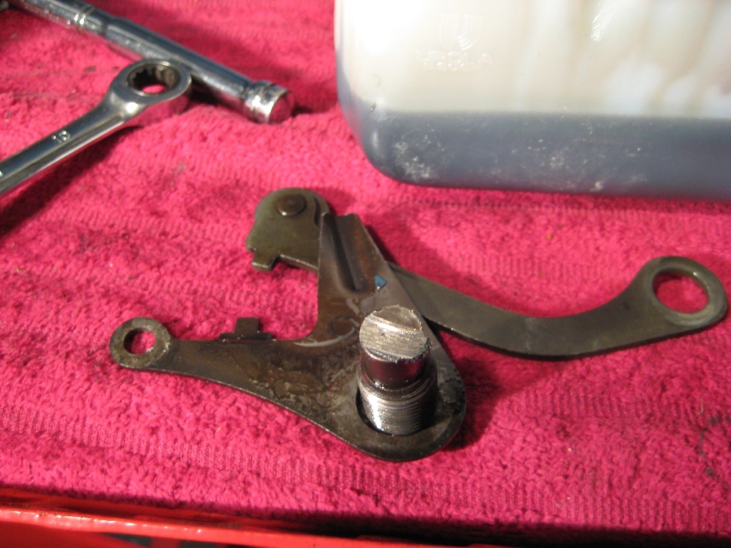

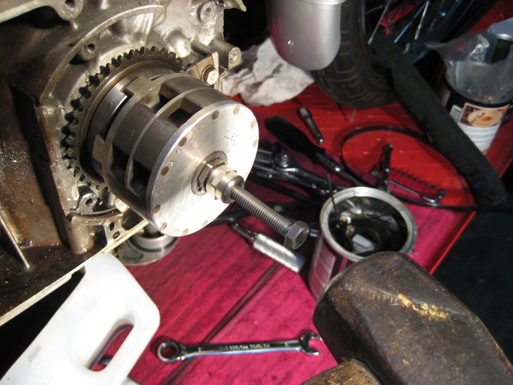

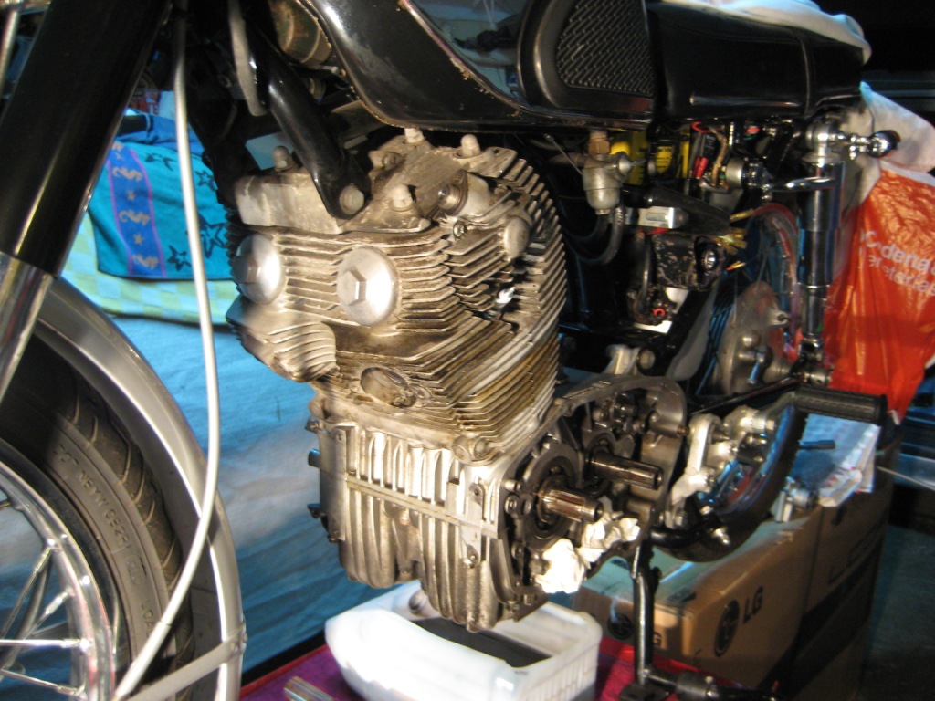

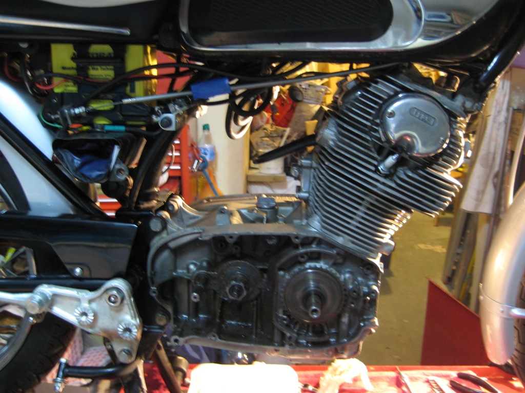

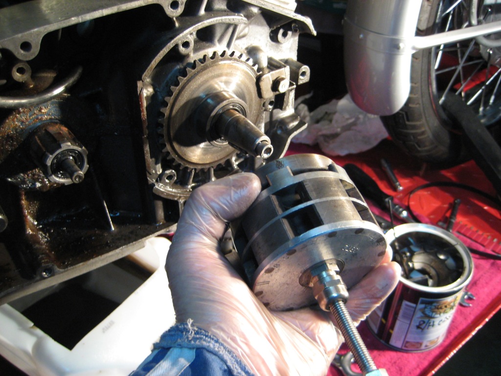

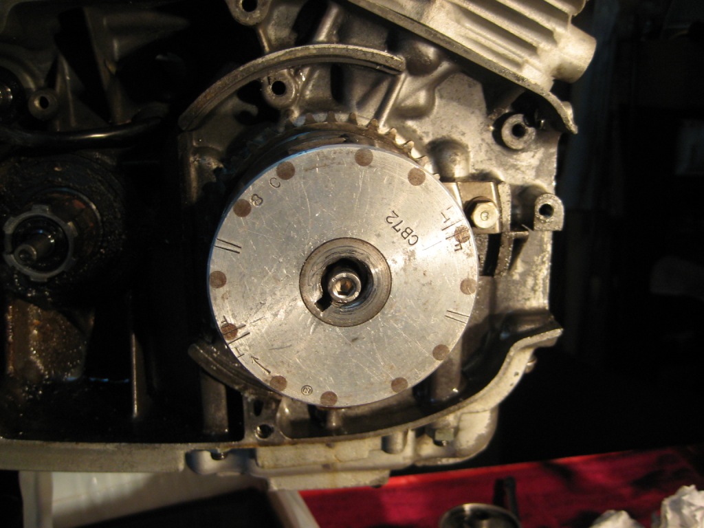

So I managed to scoop up some garage time after dousing myself with a bucket of enthusiasm. Here's where I'm at after an afternoon's peaceful pleasure away from Her and Her Self-Loading Galloping Gob.
Looks like the transmission needs a bit more attention than I thought, but I'm ready for unforeseen eventualities!
I've taken many pics as aides-memoire for the rebuild and for posterity; here's a few, highlighting some salient points:
