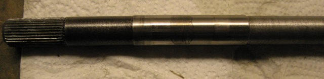

Thanks for the advice...upon closer inspection, it turns out that my countershaft is bent. Radial runout measured 0.012" at the worst. I have another one with only .001" of runout, but the kickstarter splines are pretty chewed up. Western Hills Honda lists the part (kick starter spindle) for $140, p/n 28250-259-000. Unfortunately this is the later design, the earlier is 28251-259-000, which is what I need according to the parts book. Anybody know how to get one?LOUD MOUSE wrote:There is no reason the trans changes as you turn shafts.

Also my mainshaft showed about .002" radial runout...should I be concerned or use it as-is?

They are the same part. Honda superceded the numbers. Did the bad one have a groove where the 1/4 inch rollers contact the shaft?. .......lm

The shaft looked allright in that area; can't feel a groove, just some slight discoloration. Thanks for the p/n info, LM. Should I worry about a bit of runout on the mainshaft?LOUD MOUSE wrote:They are the same part. Honda superceded the numbers. Did the bad one have a groove where the 1/4 inch rollers contact the shaft?. .......lm
Or just replace the countershaft and check for binding?
Also I think I'll try to straighten this one out. If I mess it up even more, oh well!
