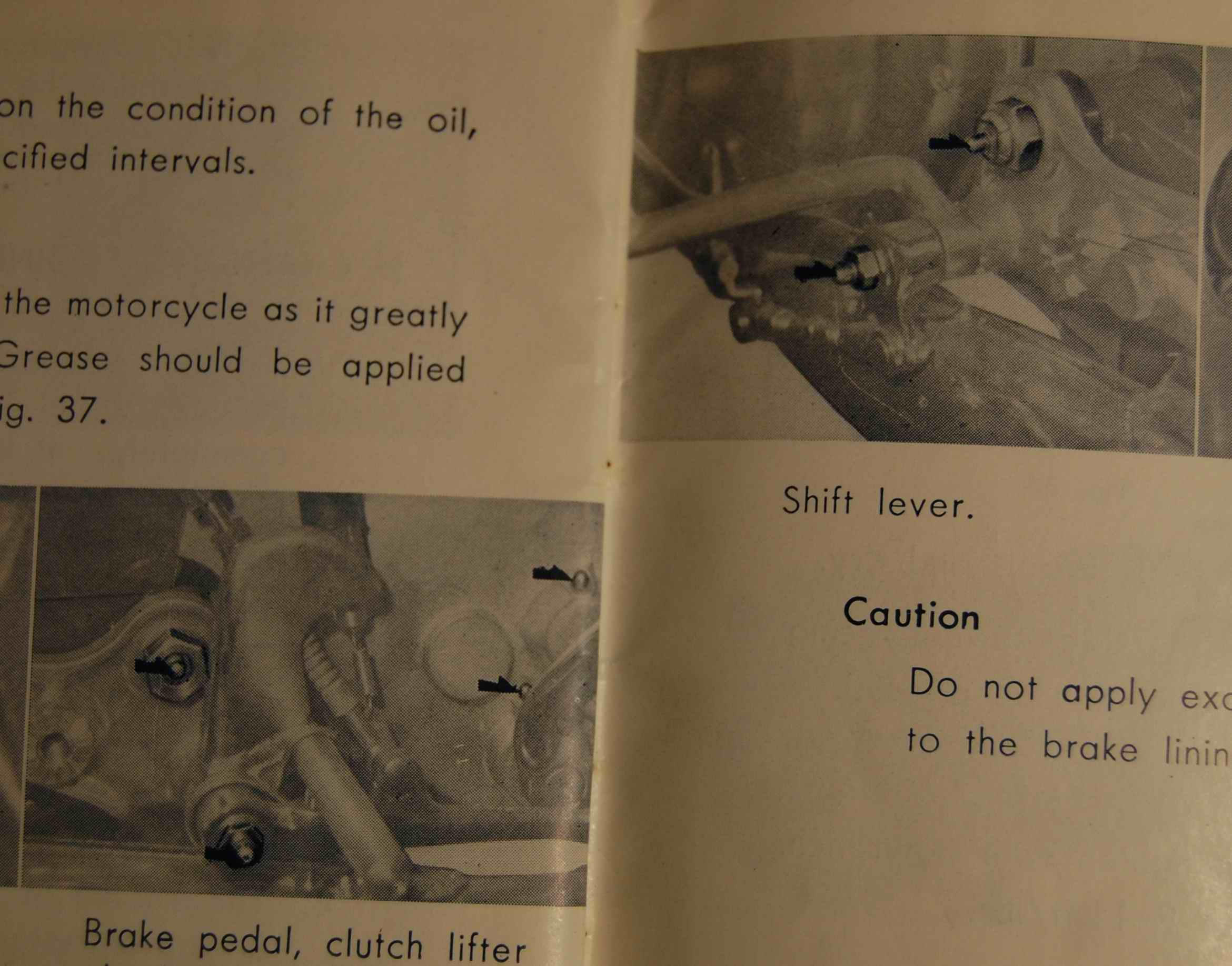

"The swing arm bolt is installed from the wrong side. .................emo"
And my response: "Really? Clymer book shows it going from left to right, that's how it was when I took bike apart, that's how I reinstalled it. However, my owners manual shows it going right to left now that I look at it. Thanks, Lee"
It really amazes me how Ed can pick out tiny details like this from low-res photos we send in. What eyes!
Needless to say I removed bolt and replaced it from other side. it was easy enough, might as well get it right, even on this "rider."

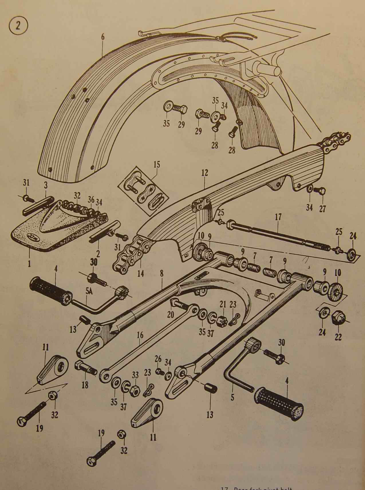

Hope this comes through good enuf to show what's what. It definitely shows bolt head with recessed grease fitting on right, jam nut on left.
I wonder how many bikes have swing arm bolt installed from left to right based on this illustration.
