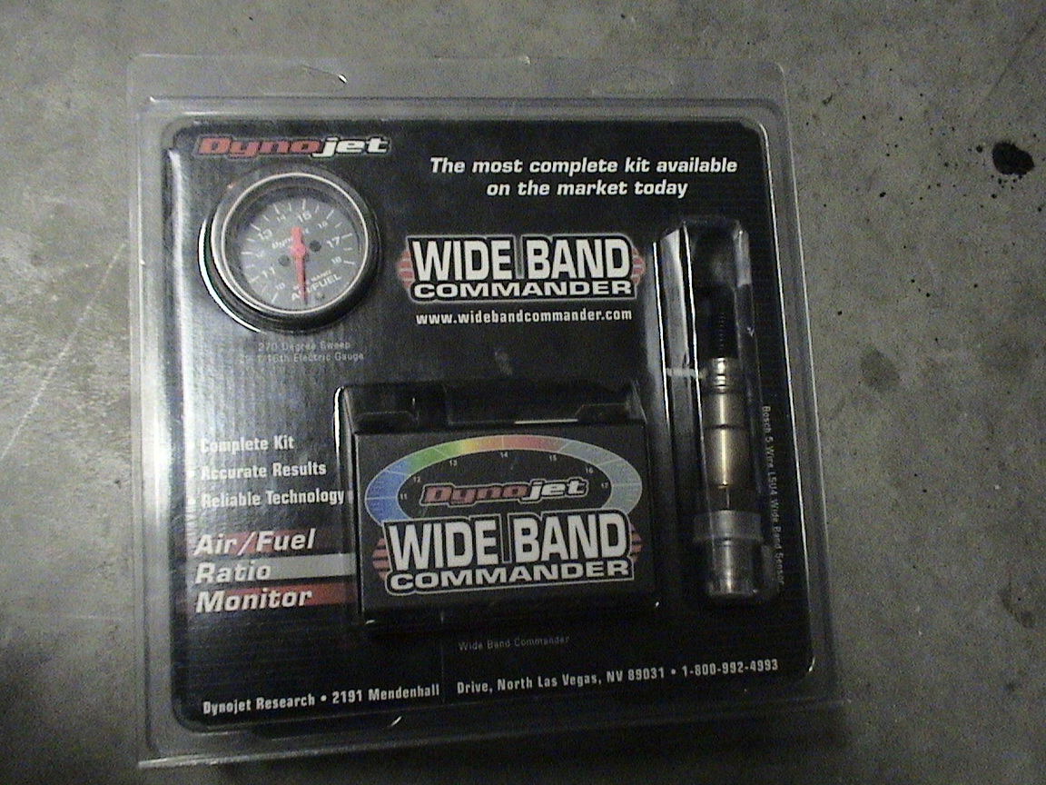

Finally found a smoking closeout deal locally on one of these and couldn't resist.
Hopefully it will help me deal with the insecurity issues involved in reading plug chops!
Now to figure out how to mount it or go with the slide in the tailpipe method.
Doesn't look too complicated?!?!
Dynojet A/F Meter

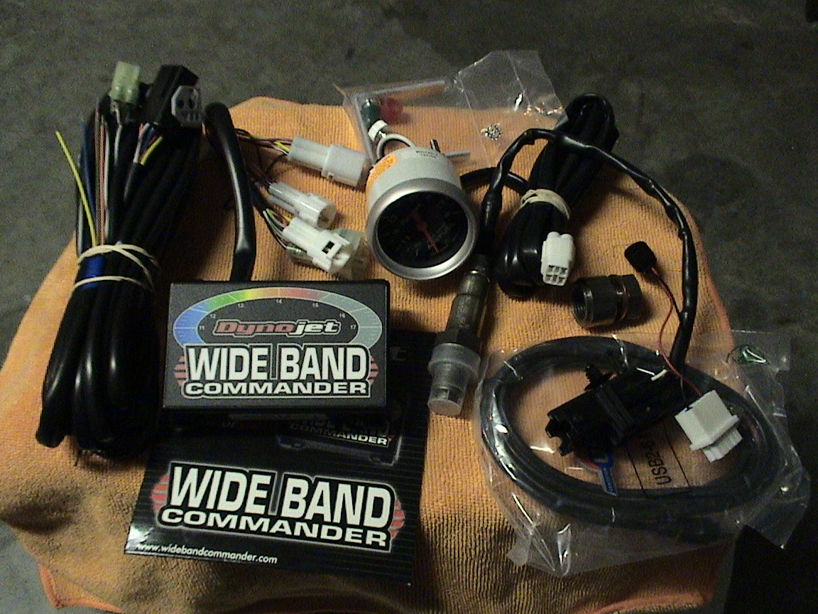

Here is the slip in type I may use if I decide to go portable:
http://www.daytona-sensors.com/download ... h_Note.pdf
Ideally, I would like to be able to read as I ride under varying load conditions, so I can target carb circuits that need to be adjusted.
The slip in sniffer version could be attached to the exhaust, with the module and guage temporarily attached by a tank bag etc.
I also have another bike I need to tweak also, so this would be the most versatile option.
Permanent install with a bung in the optimal location would give more accurate results, however.
Instructions recommend the sensor be within 30" of the exhaust port, and with the 1/4" intake with the slip in option, I could meet that for the sampling point, but not the sensor itself.
I don't think the 1/4" tubing in the exhaust would significantly alter the results if the larger sensor-contained portion is not blocking the mufffler exit.
No fuel injection, just looking for the best carb tuning.
