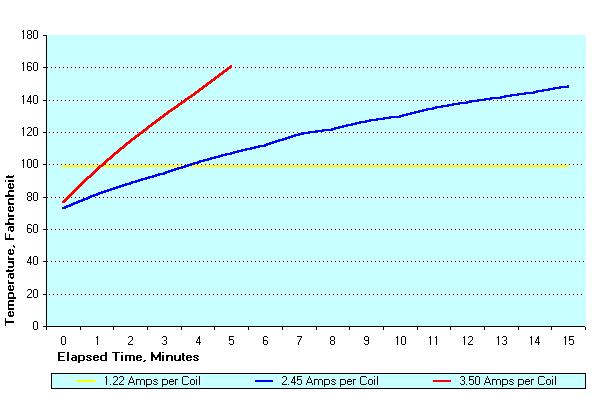

Time v. Temperature Chart  -  Control Module
h305 e-Ignition: Time & Temp Chart

Ignition "On" Motor "On" Ignition "On" Motor "Off" Ignition "On" Motor "Off"
Please Note:  It is not a good idea to leave the ignition in the "on" state, when the motor is not running. This applies to any bike with any type of an ignition system. However, if you absolutely must, the above table details the length of time the ignition can be left "on" without the motor running, on an electronic ignition equipped Honda Superhawks and Scramblers. Full explanation can be found in the Electronic Ignition FAQ.
