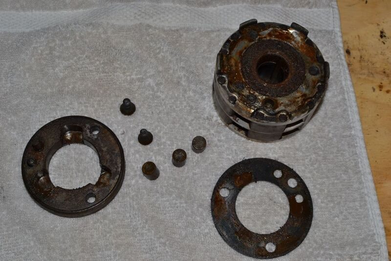

Well, I pulled the rotor. Required a little nudge with an impact wrench but it slid right off. It looks nasty. I didn't see anything that looked like springs or caps as provided in the rebuild kits. This unit spinning would have emitted a terrible racket so I think I have found at least part of the problem. I wonder what would have generated the torque to shear these machine screws? Is it repairable? Looking inside this starter clutch I see three rollers inside the starter clutch. Where are the caps and springs located? Do I need to take off the sprocket and chain or is taking it apart this far enough? Re kickstarter - splines on shaft are damaged. Starter motor will turn the chain and sprocket smoothly with no clatter after taking off the rotor and starter clutch. Pics attached

Like the immovable object colliding with the unstoppable force - something had to give. At some point, corrosion or mechanical damage froze the mechanism as the starter kept cranking. The good news is that the starter still operates (?).
Clean up the mess, closely inspect the parts, extract the sheared bolts if possible, and size up the situation. Parts (used and maybe new?) can be had to rebuild/reassemble the clutch.
Make sure the rotor keyway and woodruff key aren’t damaged.
Don't underestimate the torque of a starter motor! It also looks like the rust weakened the screws.
Yes, it's repairable. First, be kind to the magnets. If you hit the rotor or drop it, the shock can diminish the strength of the magnets and good replacements are hard to find. David Silver Spares has some parts for sale although they aren't cheap. You may find some on Ebay too.
I would degrease all of the parts and remove the rust with something like Metal Rescue or Evaporust. Look carefully for cracks in the clutch piece. A crack will allow the clutch to expand when used and the rollers will not jam between the crankshaft and the clutch piece.
Your problem could have made the loose chain sounds. You can check for wear marks on the insides of the covers to see what the chain has been up to but I've never heard of anyone replacing this chain. Give it a good lubrication before installing the covers.
