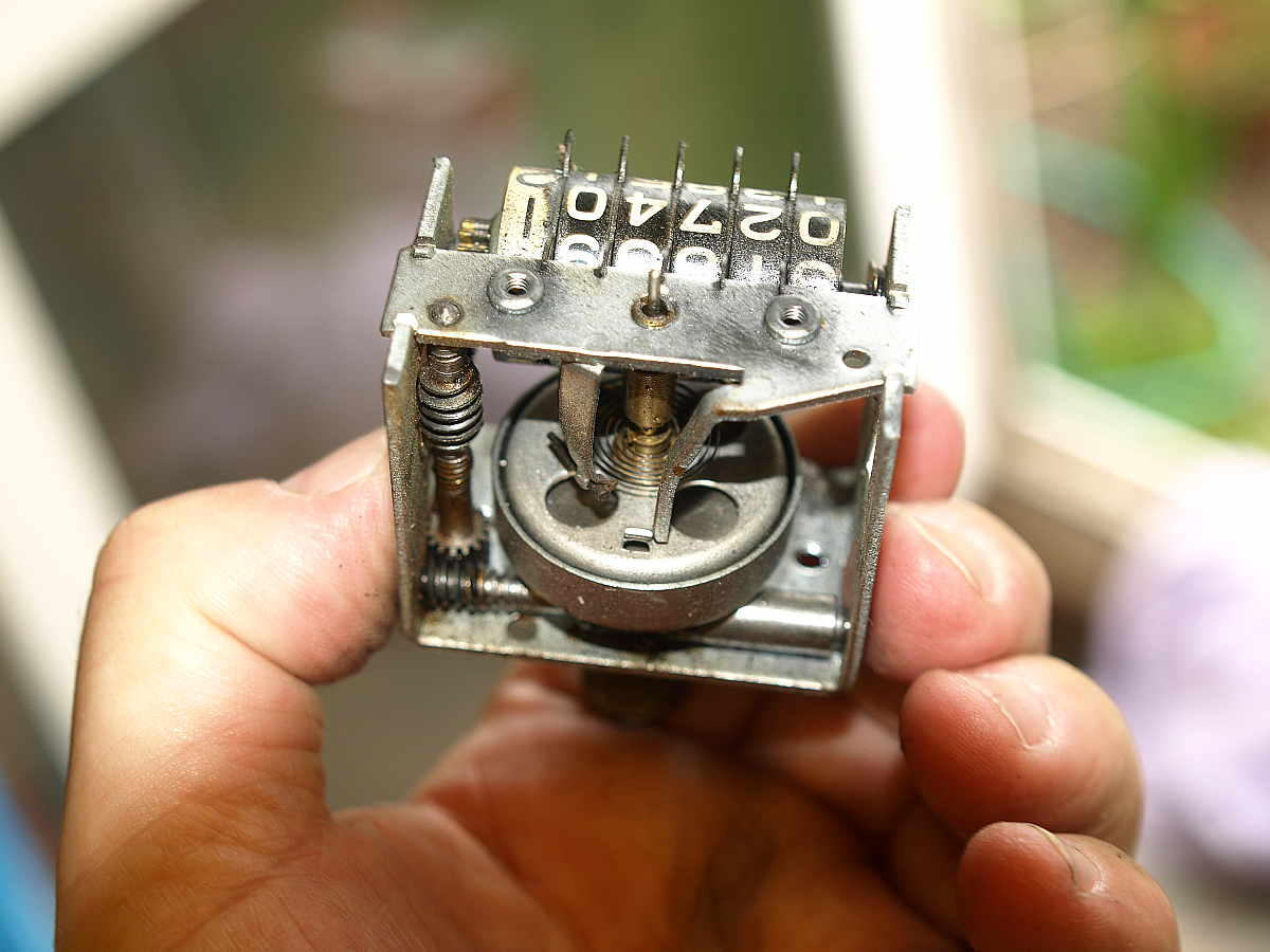

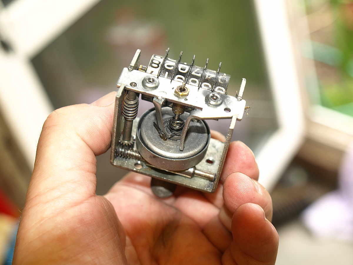

Sounds like the bearing on the input to the speedo has dried out so that your new cable winds up then goes 'twang' as it gives way - whizzing the needle around. You need to take the speedo off and turn the input with a small flat screwdriver to see if it turns freely. If not, try a little lube. You may have killed the spring in the speedo, like the one in the picture below.
If so you need either a good speedo repairer or a replacement. The pictures are from a dismantled speedo. You don't need to go this far just to twiddle the input shaft. If you spin the shaft in the right direction, the speedo needle will move briefly. If it's still reading 110, then it's all over.
Spring has been damaged

This is a working speedo
