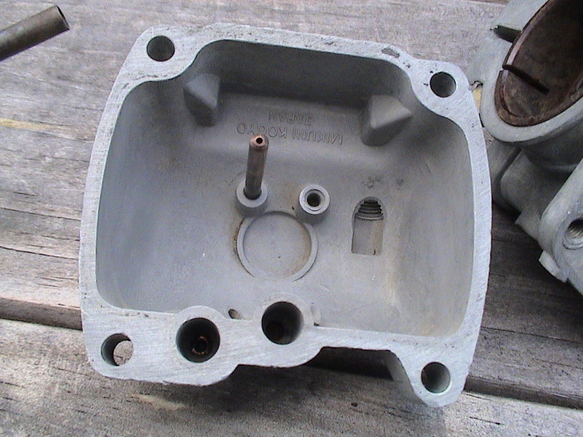

Had to clean up an old petcock from a Suzuki TC100 which was clogged up bad and didn't want to screw up the plastic strainer, so I decided to try vinegar and see what happened.
Threw in the carb also since I had it apart anyway and heres what happened:
I mixed white vinegar and hot water 1/2 and 1/2 and let it soak for an hour or so. Then brushed with an old toothbrush:
It leaves a thin oily film on brass which is easily wiped off. The large brass idle adjustment holder shown to the right had a crusty coating which carb cleaner would not remove, but the vinegar took it right off.
I always seem to squirt carb cleaner in my face when cleaning the passages, but this way I could squirt water from the kitchen sink through them and not worry about losing my eyesight!

Update
Decided to try the Pine Sol method also to see which was better.
After reading several posts on other forums about the results of Pine Sol, I was expecting a miracle.
Newer carbs must be made of a different alloy, as the pics on other forums showed shiny metal, but they were obviously from newer model bikes.
Here's the result of 50/50 Pine Sol and Water solution after soaking for 3 days:
(Also one showing my method of flushing the passages,...wife threw me out of the kitchen sink)
