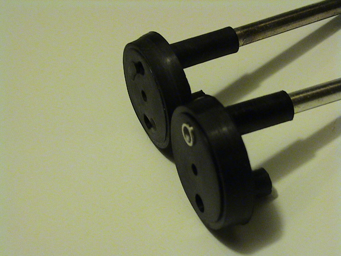

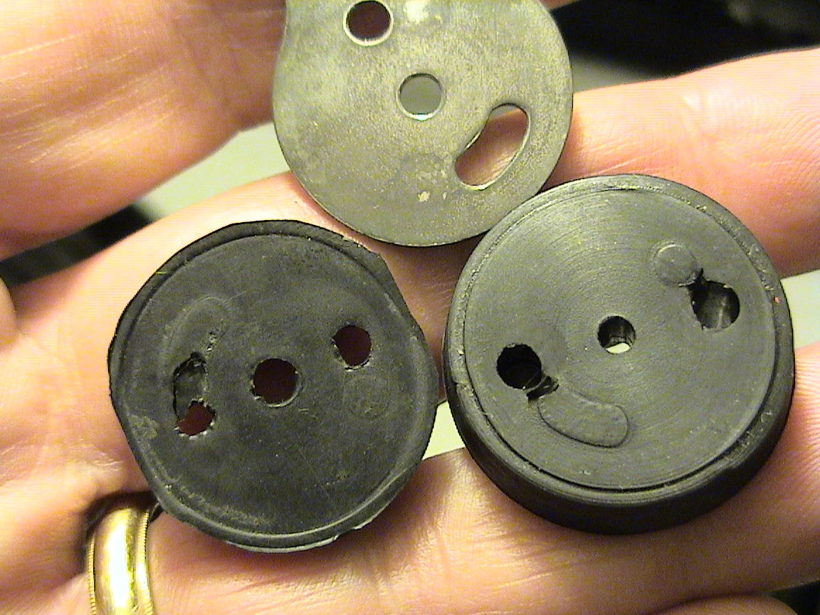

Attached pics show the tearing of the rubber gaskets which caused the leak.
I didn't find any rough edges on the lever plate which could have snagged the gaskets.
Got a replacement kit from RetroBikes which appears to be from a different manufacturer and gives a choice of rubber or cork gaskets. (cork gasket is slightly thicker)
Wondering now if I should bend the spring tabs down some on the pinwheel to relieve some pressure?
Also looks like the fuel tube from the new kit needs some adjusting, as it extends thru the rubber and out the bottom end!!

I was all hyped up to use the cork, as I didn't have one in the last kit.
What has me worried is that it is thicker (0.16 vs 0.13") than the rubber, and you can see the bulging in the old rubber gaskets that matches the lever plate hole/slot from the (possibly excess) compression.
After installing the first kit, the lever was pretty tough to move by hand.
Since cork isn't as tough as rubber, I'm having second thoughts.

Ok, I smoothed the inside edges of the groove and hole in the lever plate with a whetstone and polished with a Dremel.
Soaked the cork gasket with oil, and installed everything back into the tank.
I didn't torque the screws all the way down so that the petcock metal seats against the tank metal as I did the first time.......just snugged them equally.
No leaks and reasonable lever friction feel.
Maybe over torqued the screws the first time.
