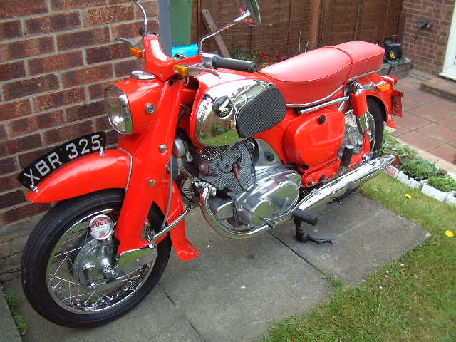

Hi,
I have a 62 model C72 with pressed steel bars, and I had to replace the original forks last year and replaced them with a set off a later year, so the mounting holes are the same. from there up you will need all of the older parts. The switches are different, lever pivots, mirrors, all of the control cables, - plus the pressed bars will have the winkers inset. These winkers use a different watt bulb to the later models. good luck if you go ahead.

- h305 Moderator
- Posts: 2600
That's a lovely looking C you have there; congratulations! I'd wager that those casings take some upkeep!!pc13cb92 wrote:Hi,
