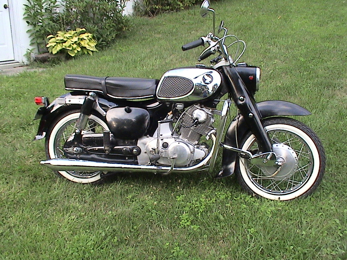

Post by brewsky » Sun Jun 19, 2011 10:02 am
Here's a pic of the above style mounted on my CA77:
They are about as close to original shape/style you can get in an aftermarket.
They are pretty restrictive so I ended up poking a couple holes in the baffles to open them up slightly.
They are not slotted on the inlet end to clamp tight on the header, so you will need to make your own slots and add a clamp or seal with some sealer if you want a leak free connection.

Post by G-Man » Sun Jun 19, 2011 2:05 pm
Brewsky
Thanks for showing the pictures. They look pretty good on the bike. What's the quality like? They're pretty cheap compared with hunting down originals.
Post by brewsky » Sun Jun 19, 2011 3:16 pm
The quality is fair. You can see the weld seams up close, and they came with a small ding in one pipe from the vendor. Had to tweak one mount that didn't line up exactly.
But, they have been in use for a couple years or so now, and no rust or other issues yet.
Most people, other than 305 purists, think they are original, and for $100, they are what I expected.
I do like the shape on the Dream.
