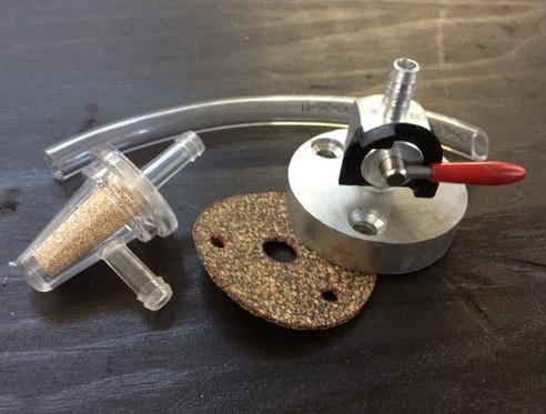

modern petcock on ebay
a guy on eBay is selling one that is off a Harley . It comes with a three hole adapter so it should work. I ordered one so I'll let you know how it works out.

Re: modern petcock on ebay
I think that guy's design is kind of primitive, so I made my own and am selling it on eBay as a competitor product. Notice the 90 degree filter. The other guys design has no filter.dlobby12 wrote:a guy on eBay is selling one that is off a Harley . It comes with a three hole adapter so it should work. I ordered one so I'll let you know how it works out.
http://www.ebay.com/itm/271018122754
