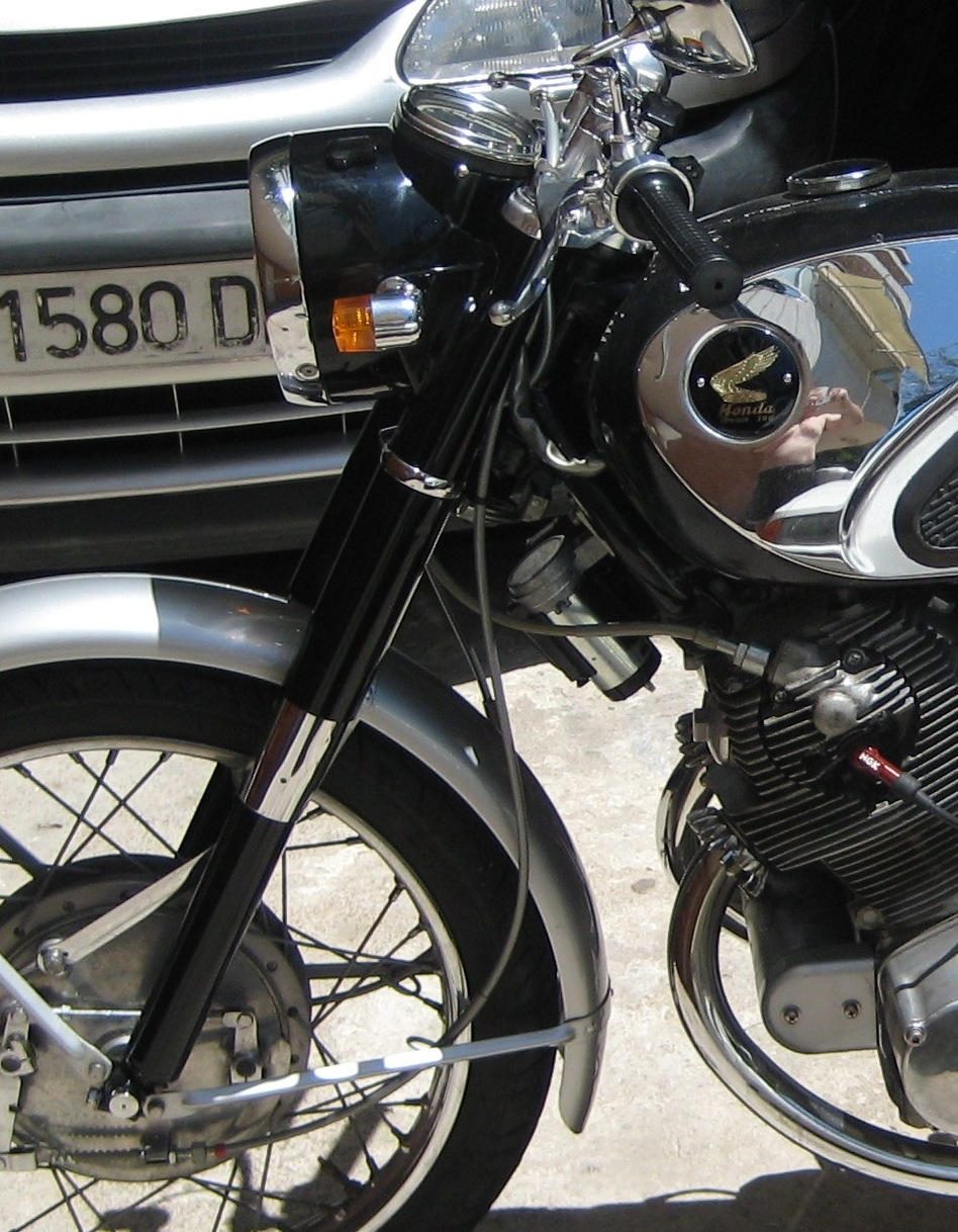

OK, here's what I have (with the flat, factory NOS handlebar):e3steve wrote:Hmmm, "standard" huh? That old castaña!houseowax wrote:So just standard cable length for those low-rise bars then?
Somewhere on The Forum I, and others, have posted some measurements of differing types of cables. I'll search and rescue for you, sometime today.
The important dimension for the throttle cable is from the grip to the Y-split, as from there to the carbs is the same no matter which 'bar you have.
- My throttle cable, grip to Y, is about 14".
My clutch cable is 34".
My front brake cable is 41".
- h305 Moderator
- Posts: 2600
The CB's routing is quite straightforward compared to the C/CA models. See images below.houseowax wrote:Right. Guess I should've known.
Thanks, Steve. I'm getting pretty well-versed in all the kinks, loops and inconsistencies in the CAs but I've yet to start on my CB. I'm sure I have volumes to learn there.
Incidentally, from the levers' perches, the clutch cable passes between the front brake cable and the headlamp; i.e. ahead of / in front of (left over right).

Note too that the throttle cable splitter should rest on top of coil for smoothest operation as shown. Hi Steve!
