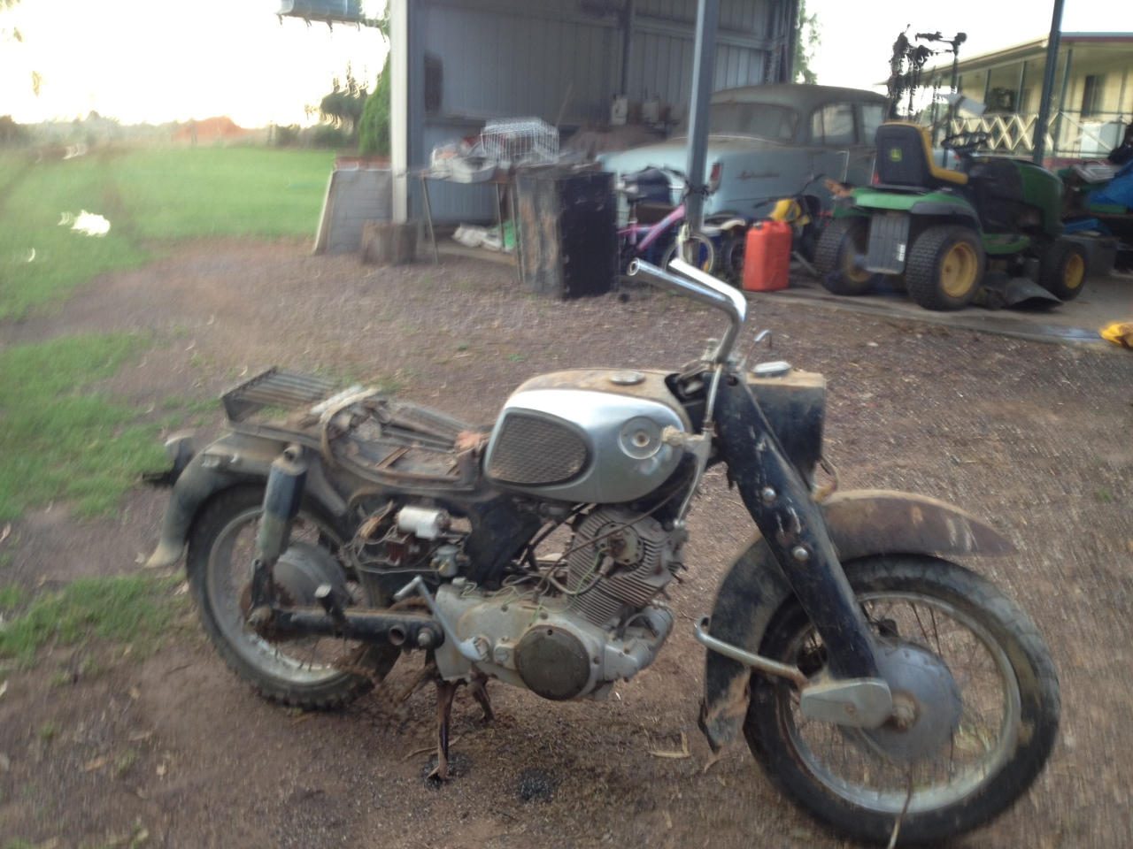

Thanks fellas, I'll look into those places.
From what I'd read I thought the numbers were a bit odd, I thought the numbers matched with these bikes for the most part.
I'm unsure if it has had a replacement engine but I doubt it as my grandfather was tight and got the most out of everything, which is why it's in rough shape. It was used for mustering sheep and cattle through the bush so the front and rear guards are buggered.
I've included photos (hope they worked) and as you can see it's rough, I think a donor bike is possibly needed, and a lot of cash.
I'm a mechanic so I'd like to have a crack at the engine but the body work is a job for a professional. The bike is mostly complete but the original boxed handlebars have been flogged and I presume they will be hard to track down, but I'm excited to get it happening. I also have an almost complete C102 that was my grandmothers.
Thanks again.
