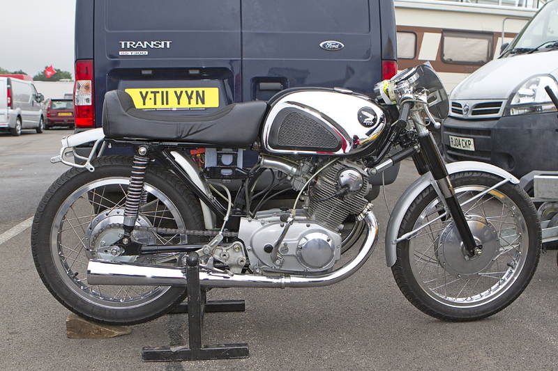

I'm wondering wether I should restore the forks or replace them with something newer and if so from what. I want to continue using the borranni rims. What do you think?
Post by G-Man » Sat Oct 11, 2014 2:48 pm
Tunster
Depends what you are going to do with it. Mine has CB350K4 forks, I think. Probably easier to get them uprated than the original CB72 forks.
The originals have that classic Honda GP look though.......
Decisions, decisions. Time to start looking for a GT750 double sided drum, too?

I'm going to use the wheels I have purely because the previous owner has tweeked them alittle. The forks don't have any proper mudguard mounts and need a complete refurb. I will see what's about at stafford on saturday
Post by G-Man » Sat Oct 11, 2014 3:06 pm
They look like standard CB72 forks. There are two lugs at the bottom of the stanchions and two mounts at the top on the inside.
A CB160 fender looks a lot like a works Honda component and mounts just on the top mount.
CB72 with_CYB_parts_fitted small.jpg (91.99 KiB) Viewed 5030 times

Post by Tunster » Sat Oct 11, 2014 3:15 pm
That looks great. Are the forks on mine original?
Post by G-Man » Sat Oct 11, 2014 3:20 pm
Yep, those lugs you see are the top mudguard brackets. The standard CB72 has stays which reach down to the lugs at the bottom.

Post by Tunster » Sat Oct 11, 2014 3:24 pm
Thanks g-man I thought so just wasn't 100%. If I keep them I think I may need to get some brackets made to tidy up the mudguard fitting. Luckily I know a good mate that could do that stuff.
