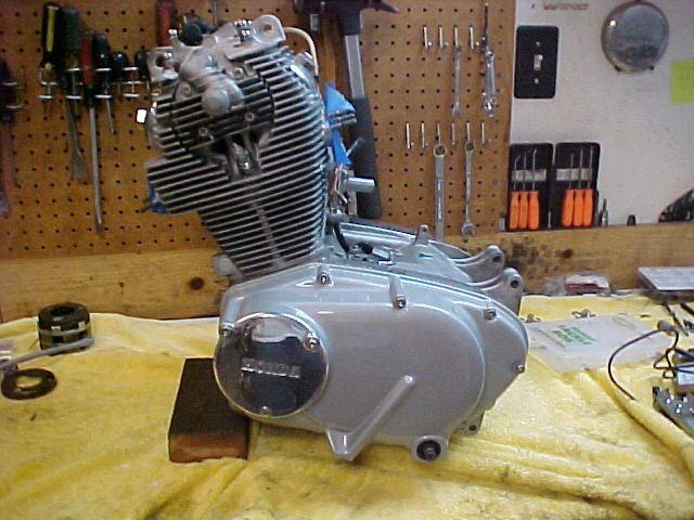

Here's some pics of the engine buttoned up. Hopefully we'll have a mock-up bike in a couple of weeks so we can fire her up. It really came out nice, with the graphic designer hounding me every step of the way! Deez has a great eye for detail, and didn't miss a thing! The list of new parts is quite long, and includes ...... cam chain, cam chain tensioner, cam chain wheel, Wiseco piston and ring kit, govener springs, points and condenser, stainless bolt kit, kick pawl pin and spring, clutch friction plates and springs, all new gaskets and seals, tappet covers, clutch lifter and thread, and surely some other items I'm forgetting! Gears have been X'ed, valves and seats cut, engine bored second over, cases bead blasted, covers either painted or polished. This is gonna be one slick Cafe' bike!
