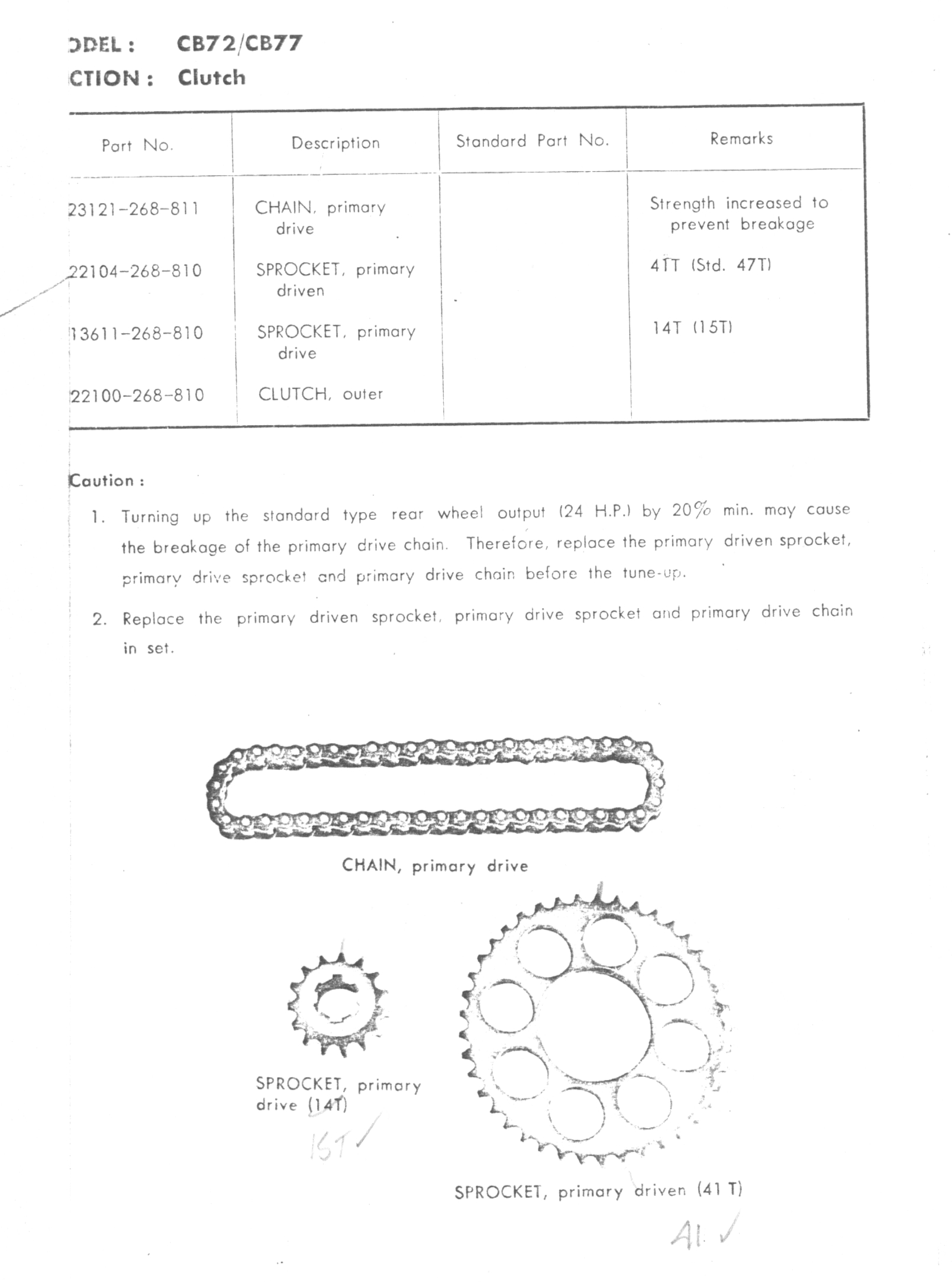

Just a small point about the Honda CYB Race kit primary drive set up, although the parts book details the front sprocket as being 14 teeth they are actually 15 teeth same as the standard one. If you count the teeth on the illustrations on the relevant pages in the parts book this will confirm 15 teeth

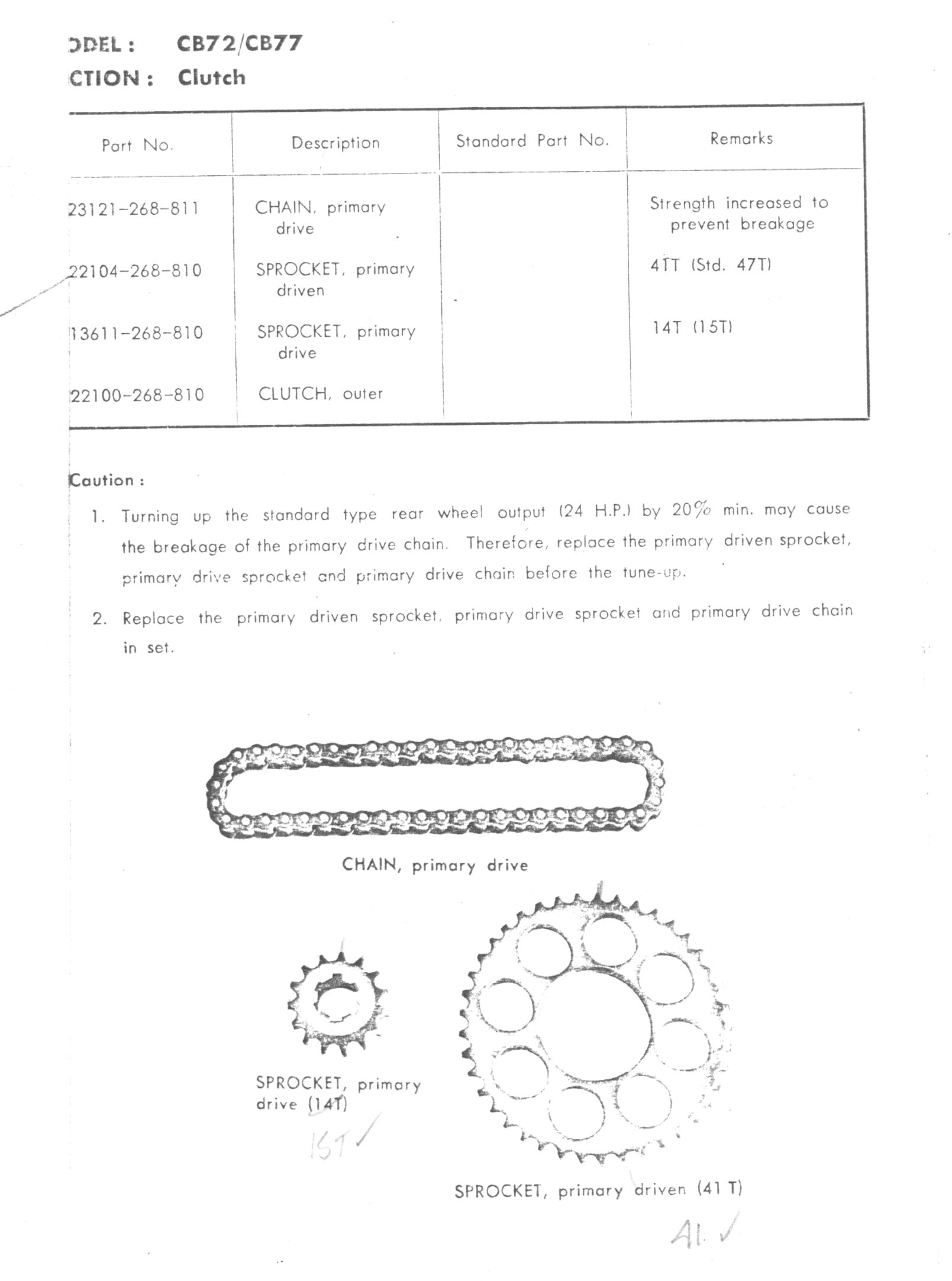

- Honda Race Parts listing.jpg (158.34 KiB) Viewed 20368 times
- Honda Race Parts listing.jpg (158.34 KiB) Viewed 20373 times
