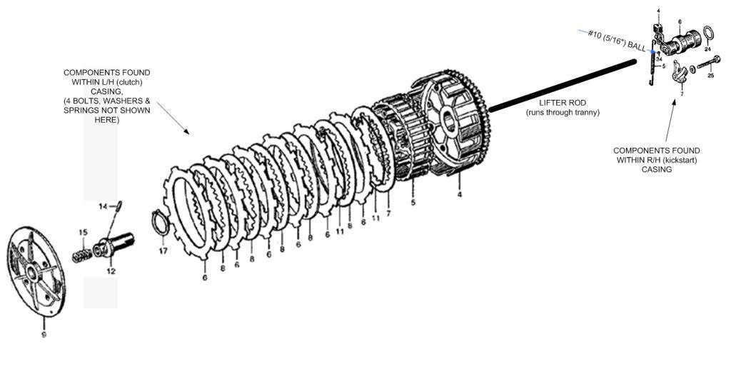

Clink....... the penny's just dropped! OK, Joel, the reference listing for each illustration is on the BACK of that page -- i.e. p77 refers to p76 -- not on the FACING page. I know...... confusing!
Regarding the rod: the clutch (l/h) end is hemispherical; the lifter thread (r/h) end is flat (squared off).
I put this illustration together a couple of years ago; it puts things a little more in perspective:
That's a great diagram, Steve. Honda should have done it that way.
WR, so you understand what is going on with this mechanism, the clutch lever on the handlebar pulls on the cable, which in turn pulls on the arm which is attached to the clutch lifter. This causes the lifter to rotate. Since the lifter and adjuster fit together with what is a very coarse thread, as the lifter turns it also "unscrews" from the adjuster which makes it move out of the adjuster. The rod's square end is inside a socket in the end of the lifter. Between the square end of the rod and the back of that socket is a single steel ball. The pupose of the ball is it allows the rod to spin while the adjuster stay's still. The hemispherical end of the rod goes into a mating hemispherical socket in the end of the lifter joint. The lifter joint presses on the clutch pressure plate. When the adjuster pushes the rod, it pushes the lifter joint which in turn pushes the clutch pressure plate and compresses the springs in the clutch which allows the clutch plates (drive and driven) to slip relative to each other (disengage) So, the rod spins because the clutch is spinning.
If the engine is not running it really does not matter what condition the rod or ball are in. The ball could even be missing for that matter and it would have no effect on clutch effort. I'd have to see which direction the clutch spins relative to the lifter to determine if a running engine would put some force on the release mechanism if the end of the rod were chewed up or if the bearing was missing. But if you have a clutch that requires a lot of effort to disengage, then either the lifter is not greased or otherwise free to rotate in the adjustor, the cable is rusty or crusty inside, or you have extra heavy springs in the clutch.

Thanks Rob; it just made sense to orientate the illustrations into a logical diagram -- like orientating a map. I overdrew the wiring diagrams in colour for the same reason -- to make things easier to follow.Snakeoil wrote:That's a great diagram, Steve. Honda should have done it that way
regards,
Rob
The clutch lifter components must go together and make the correct length, end-to-end, or the lifter thread lever arm will be pulling from the wrong angle and scribing a poor arc, thus requiring more effort at the handlebar lever. The lifter lever arm probably has only a usable efficiency through about 90º.
The same applies to the shifter pedal and lever; which is why the shifter lever needs to point to 11 o'clock.

Steve, great diagram. Really helpful. It's easier to see how this things going to go back together.
