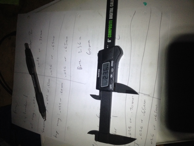

Before I get flamed, the furthest I've gone with these sleeves is deglaze them. The second time I've done it was 2 hours ago.
The bore for both sleeves, and with my cheap harbor freight digital caliper is 2.36in or 60mm.

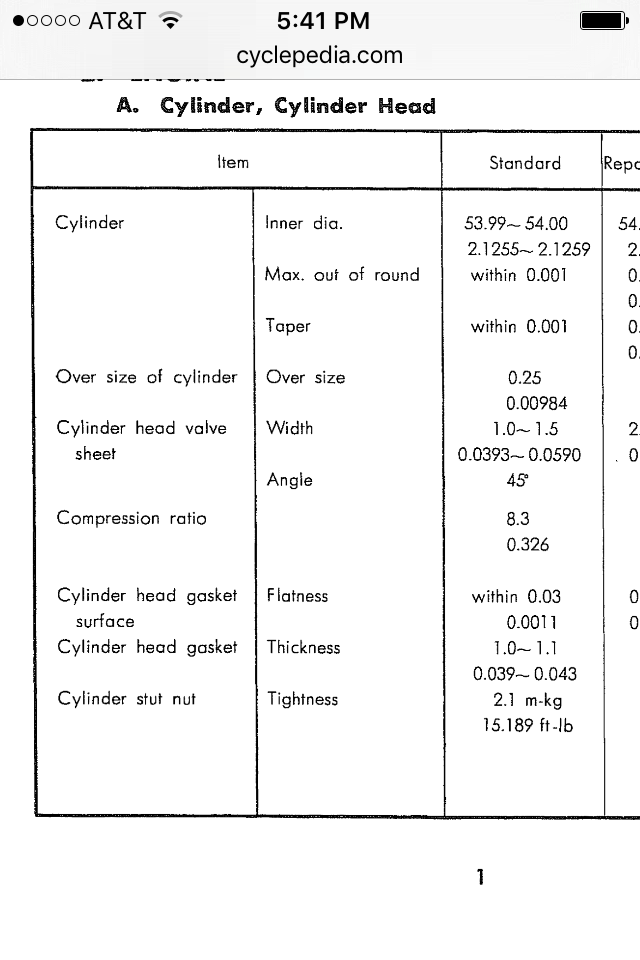

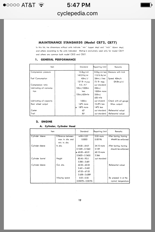

Post by Brickyard » Sun Nov 08, 2015 6:56 pm
Whoops, I was looking at the wrong specs. Here's what I have and here's what Honda says about what I have...
Just as I started to feel smart, I see the * in the repair manual and have no idea what it means
(And then i read the top of the manual page)
Post by LOUD MOUSE » Sun Nov 08, 2015 7:02 pm
I had to ask as you showed 60mm which is STD. 305 as I recall. .......:-). .....lm
Brickyard wrote:Whoops, I was looking at the wrong specs. Here's what I have and here's what Honda says about what I have...
